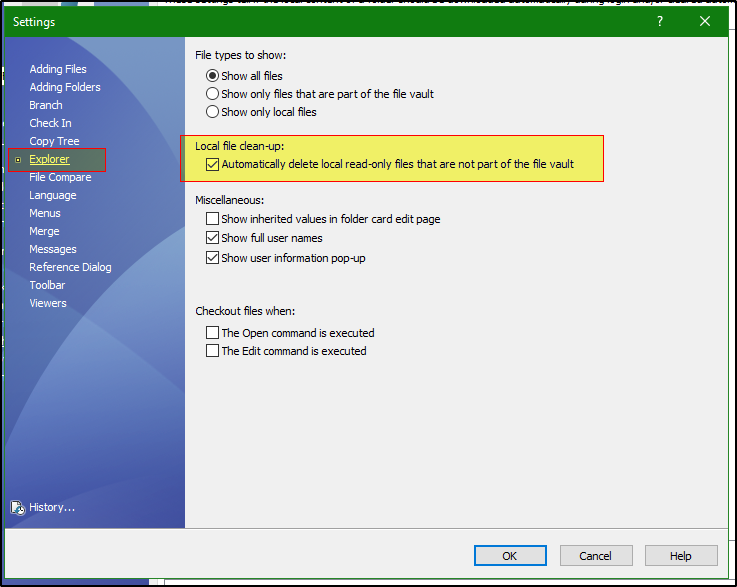

Are you using the setting “Automatically delete local read-only files that are not part of the file vault”? We are using PDM standard and when someone else moves a file, we get left with local files if we had previously cached that file.
Before I toggle this setting, I wanted to see what risks we are likely to have with it.

“automatically delete local read-only files that are not part of the vault”
does this setting actually works?
I think grey folders are not touched as they are not files as well as private status as they are added to the vault but not read only (and this is a good thing)
according to kb
The setting to ‘automatically delete local read-only files that are not part of the vault’ will delete files that meet the criteria when the user with the setting browses into the vault folder that contains them.
Files that are read-only but added to the vault will not be deleted as these files do not meet the criteria of this user setting. To be deleted, a file will have to be both read-only and listed as a in the local vault view.

It seemed to do what I wanted in my sandbox, so the main vault now has that setting.

Grey folders are deleted as well as local files during browsing from both explorer and sw open\save dialogs.
If you leave the local files open in sw or you are Inside a grey folder in a explorer window they are locked and cannot be deleted by browsing them with another process. closing sw or the explorer window requires a refresh (F5) to trigger the deletion.
Other local files are not deleted until browsing their path so they still can be loaded by accident.
adding “search local files” to the RMB menu could help locating them, then you can export a xls list and use it to browse up to their location triggering the deletion.
AFAIK clear local cache will not clear the local files and grey folders, but only cached data that actually exist in the server.
