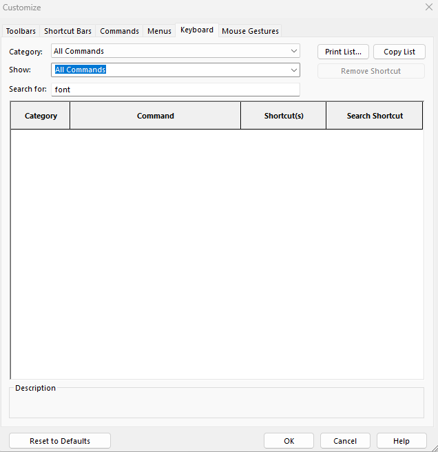

Are there shortcut keys to change font size?
In SolidWorks 2025, are there shortcut keys, or a way to program a shortcut keys, to incrementally increase and decrease the font size of, for example, an annotation on a drawing?

there is not a key board short cut

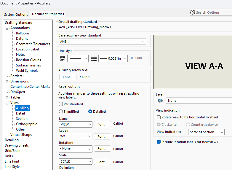

what you can do is go thru the document properties if you are looking to modify specific note sized for views or other items and specify there the differences that you would like to see.

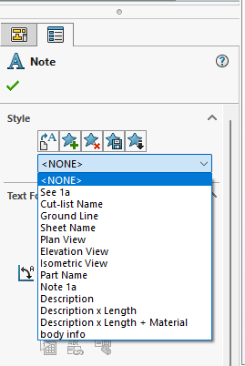

I save mine as Styles. I started doing that years ago when I was having problems with notes in the design library (if I remember correctly I wasn’t able to insert the same note more than once in a single drawing). It has worked very well. One bonus is that I can save different notes in each template.
