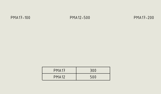

This would be an example. The three notes consisting of PMA is what I already have on a drawing. What I’m trying to do is to accomplish this table (the first column in this example are PMA17 and PMA12 since they are the only notes with prefix “PMA” on a drawing) and the second column is a number after - and if the number is same after PMA then the numbers after - should sum. Since there is PMA17-100 and PMA17-200 then 100+200=300.
And this is an example so the number of rows is unknown since there are always different PMAs on different drawings. But notes consisting of PMA is always in a form of PMAxx-xxx (x is a number). I don’t know if this is possible to accomplish :confused:
