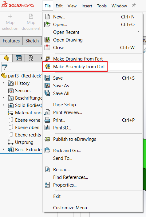

API command for "make assembly from part"?
Is there an API method for this user action?
I know I can create a new assembly via ISldWorks.NewDocument(…) and then add a new component via IAssemblyDoc.AddComponent5(…).
But since IAssemblyDoc.AddComponent5(…) does not work if the IAssemblyDoc is invisible, which is a requirement for me, I am looking for alternatives in hope of finding something that works without the user noticing anything.
