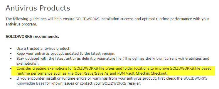

These days most AV is very similar, the biggest thing with SOLIDWORKS is to ensure that you can add exceptions via file type extension (*.sldprt, etc.) and/or folders. This way it can ensure that the AV will not try to scan SOLIDWORKS files or working folders that it uses.
Source: https://www.solidworks.com/sw/support/antivirus_sw.html
Good, it didn’t say turn off AV to install.
