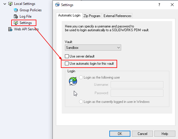

I’m not sure how to do that. When I RMC on the Blueberry, I log out. Then when I RMC again, my choices are to login, but doesn’t give me a credentials screen. I logs me in as my windows log-in.

Hello @Dan Bovinich . IIRC, I believe that if you login using the built-in “admin” PDM account, you can search for AND delete those private state files from the database. The admin account is the ONLY user account that has this ability. I had to do this last year when one of my users went on medical leave and never came back, leaving over 400 files in Private State.
If you launch the Administration tool, you can select under Local Settings at the bottom of the tree, Settings. It should open the dialog box shown below. Uncheck automatic login in order to receive the login prompt and switch user accounts.
