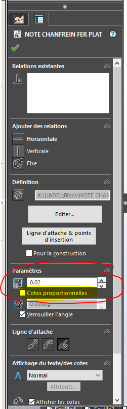

This could also be something that plays a role in the issue, as usual sorry for the frenchness:

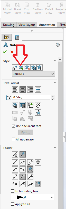

I believe gupta9665 found your issue (he’s good at that), but regarding the blocks, I use note Styles instead of blocks or library notes. It works well for me. You can have different Styles saved in different templates, which can be helpful.
m2shell’s refering to a block with visual information inside it such as this
Edit: Just for reference, a block inside a block will most likely cause the same issue if you have “Proportional dimension” checked
