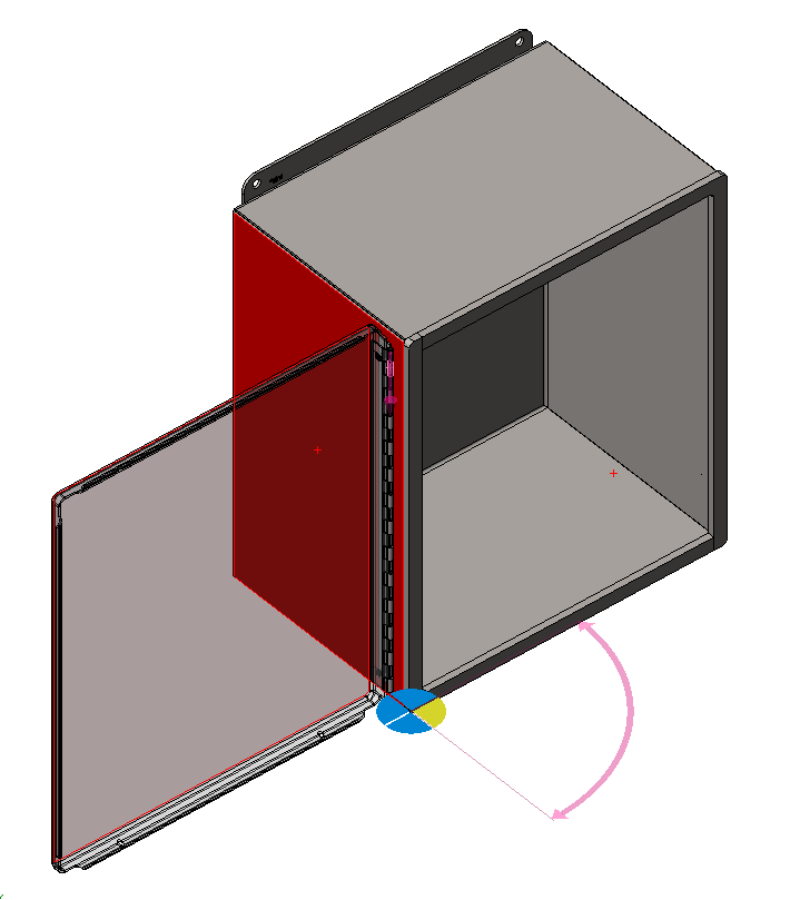

Several years ago SW added the reference entity to the angle mate dialog to help with the flipping issue. Along with that they added the “dimension selector” to give the user to ability select the quadrant they want to reference for the angle dimension itself. For some reason, this dimension selector is no longer showing up. I checked with a colleague and it also is not working on their machine. That feature is still included in the SW2021 help documentation. Anyone know of a setting that changes the visibility of the dimension selector? When editing the angle mate the dimension doesn’t show either. I feel like it used to as well. The only way to get the actual dimension to appear is to double click the mate in the feature tree (not editing the mate directly).

In the second shot included in my message you will note that the reference entity has been selected, yet no dimension selector visible. I tried selecting multiple different reference faces with no success. This is something that I have used extensively in the past without issue. I don’t know when it stopped working.

Hmmm… I’ve picked faces before without issue. You got me thinking, however. I messed around with the same assembly from my earlier screenshot. I was stumped for quite a bit, but eventually I figured it out. If you pick mating faces that are either 0 degrees or 180 degrees it will not give you the dimension selector. You have two choices, either change the angle dimension in the mate dialog to something other than 0/180 or select faces that are not either of those angles. 90 and 270 are fine for whatever reason. Attached are screenshots with the same faces selected, but one at 180 and one at 90.
