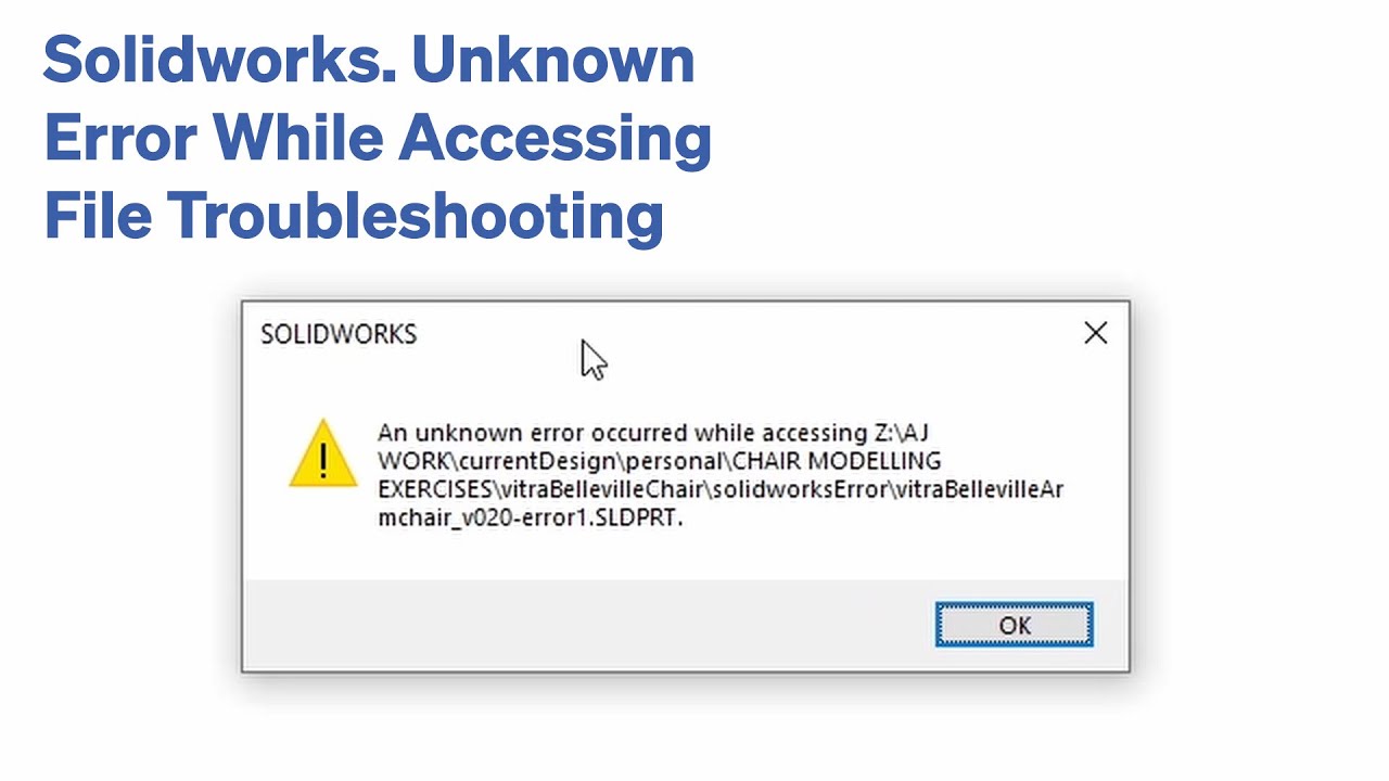

"An unknown error occurred accessing xyz.SLDPRT"
I have been seeing this error since at least SW2004. Modelling away happily, saving as I go and then bam - the error above pops up on a save.
Can’t save, can’t save to a different file name. Can’t save any assembly that might be open containing the errant file. Just lost 45 minutes of work (Friday night special) despite having spammed CTRL-S all evening long.
Anyone have any ideas what causes this? It’s not an easy problem to capture - haven’t seen it for a few months - but it always loses significant lumps of “saved” work when it happens.
