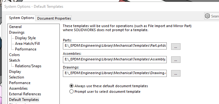

You can alleviate some of the variability by making sure the Default Templates are set:
Setup default.
Setup path for templates.

I shouldn’t pick, but I’ve found that the defaults cannot be set until the path is set AND close the settings dialog. Once templates file path is set and settings closed, then can set the defaults.

What I see is the default templates not staying set to our templates and reverting back to the installation directory. Also see the file location seems to switch back to installation directory. I’m not sure what all happens on the users PCs, it’s like a sock drawer out there. I thought it would be a good idea to put the templates in Vault. Again, I’m not sure what all the individual players are doing; user, PDM or SW, but they all seem to be ignorant of the other in many ways.
Example if for whatever reason the template files are not accessible when SW starts or when one is needed Solidworks may remove that path from file locations (it seems) also this is the only reason I can come up with why the defaults will be back to the templates in the installation directory.

Copy your templates from the vault to a read only location on your network. (Every time you make a change to the vault templates, copy over the templates on the network.
Under your general settings:
Set your template locations to:
  1. vault location
  2. some network read only location
    DELETE ANY OTHER RANDOM FOLDER LOCATIONS UNDER THIS SETTING
    (This will give you 2 tabs to select the templates from when you select a new template.)
Set the default templates to the vault location, check the radio button to always use the templates in the vault.
Lock down the settings on SW admin settings so people can’t switch those locations.
That way if the vault location doesn’t pop up, they’d be using your back up location (same templates) to select the templates.
