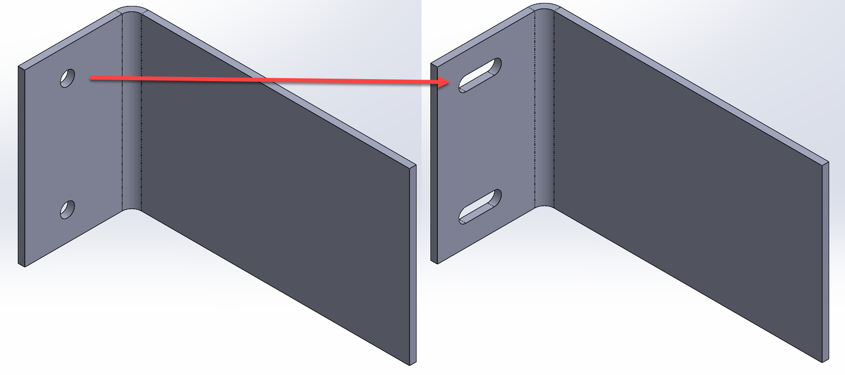

This gets complicated pretty quick and I just don’t see an easy “where-used” solution. Here is a common change we see. Holes get changed to slots, at least not for us.
The part change is considered compatible and doesn’t warrant a part number change, just revision. However the change from hole to slot usually causes mate errors or unwanted results in the where-used. The engineer will not add any where-used changes to the ECO (In their mind, the part functions fine in real life), but the SolidWorks users have to know what the impact is. Every assembly needs to be opened and checked for 1. Mate errors and fix them, 2. No mate error but part shifted position causing other issues (Interference, etc.).
This gets more complex as the above issues aren’t just one level of where-used, they can manifest all the back up at the top level assemblies. There are a number of best practices to minimize these issues that standard training never covers. Even experienced users can struggle with this if they are not familiar with building larger highly configurable assemblies.
Yes, in CAD the simple hole to slot or round to square hole will cause problems. Can also cause problems in manufacturing side as well. If the part is laser and break the holes could have been used by forming fixture pins. Also by weld fixture pins or assembly positioning fixtures. The holes maybe used to be slots but perhaps allows final assemblies to be put together in a way that does not meet customer fit, form, function and going to holes was a type of “poka-yoke” so now we may need checking or positioning fixtures for final assembly. In a highly vertically integrated company the “revise vs new number” question seldom fits into a flowchart. We have found a list of things to consider or questions to ask works better.
Of course the engineers and management lean toward revise as much as possible to avoid the painful “replace”, especially if a part has a large where-used. Either way you have to touch the assembly models and check everything. But I’ve seen too many times over the years where this isn’t done and get the common reaction from users “SolidWorks sucks, why are there are always mate errors? It was fine when I save it 6 month ago.” Many forget or don’t realize that they are not dealing with static files like a PDF or Word file.
