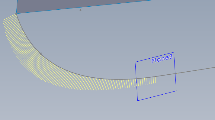

This looks good on the first glance… Unfortunately, if I turn on Surface Curvature Combs, the longitudinal combs reveal that near the front of the boat, the surface turns concave:
This only happens with Surface Fill… That spot is good with Loft or Boundary. This is how it should look - surface convex all throughout:
