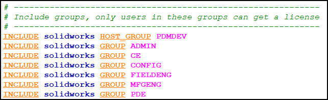

We have SNL licenses and I have an options file setup that requires the users Windows username to be on the include list. My SolidWorks batch script pulls the logged in username, then checks it against the file to see if the user has been added.
Options files entries:
