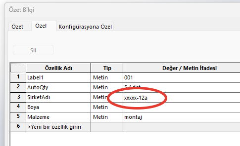

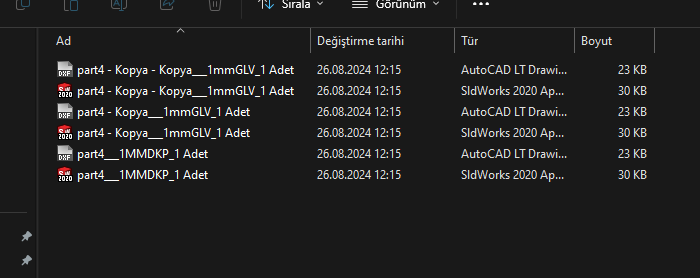

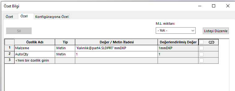

I want to add sheet thickness and quantity to the file name you saved, I’ve been trying for about 4 days, but I still couldn’t get a result.
the quantity and thickness I want to add is in summary information/Custom.
Is there anyone who can help me with this?
For example
The result you want = Part1-1mmDKP-1 Piece

You have to put “$PRP:” before a the custom property you want in the file name.
You also have to enter the address of the folder such as “C:\New folder\DXFs”. You had entered “D:” but you have to enter “D:\DXFs”. “DXFs” is the folder the macro creates.
Const OUT_NAME_TEMPLATE As String = "C:\New folder<_FileName_>_<$PRP:AutoQty>_<$PRP:Thickness.dxf"
Attached is the macro you posted revised with the custom properties. I also attached my version of it which includes options to give the folder a different name, export with or without sketches (which would be for etching), export with or without bend lines, and enter a different location for the folder either via browsing or entering the address.

Hi Jaylin,
Thank you so so much, both work perfectly! ><
And thank you for teaching me how.

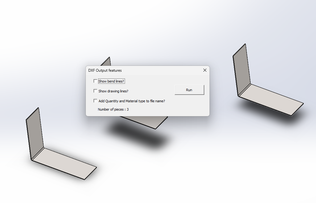

The Macro “Omur DXF Export.swp” works perfectly. Is there any way to also save .Step files together while saving DXF’s ?
@Ömür Tokman - Thanks a lot for such awesome code.
Is it also possible to insert text inside part in DXF from custom property ? In my case i have Part engraving number in custom property which I have to manually insert as Text (yellow layer) in DXF everytime. Which later on laser marked on Part as “Part number”.
This consume lot of time to open every DXF and insert text.
Can you please check if this will be possible ?
I’ll try this during the week.
Remember that I am an amateur,
you should try it before real use.

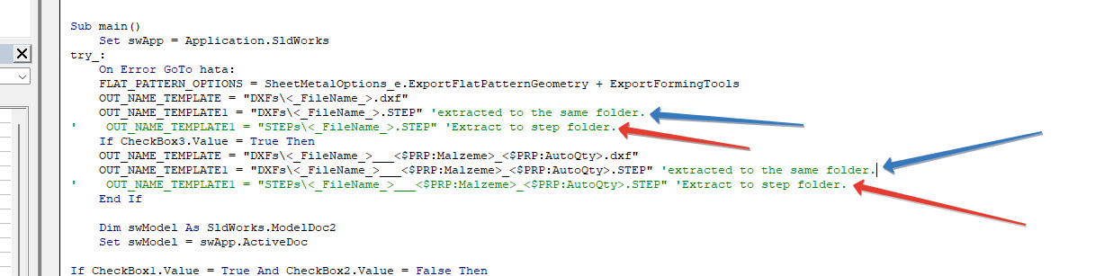

macro can extract step files to dxf or step folder. But it is related to codes. you can move this feature to the form.
It is currently set to extract to the same folder, pay attention to the codes!
in the same folder
creates different folders.

    In path, Can the name of folder “Project” defined from custom properties “Projectno.”.
    In path Can the name of folder “drawing” be defined from custom properties “drawingno.” In custom property value of this field is in format example “xxxxx-12a” but i want to have drawing folder name with left 5 characters (only “xxxxx”. Is it possible ?
  3. As previously requested - Is it also possible to insert text inside part in DXF from custom property (while exporting DXF) ? In my case i have Part engraving number in custom property which I have to manually insert as Text (yellow layer) in DXF everytime. Which later on laser marked on Part as “Part number”. text position can be at 0,0,0 (height 10)
Once again many thanks for all the help & time you provided to resolve my problem.
2 and 3 will be selected, if you don’t want the form I will leave it to you to remove it.
It will create a folder on the desktop with the first 5 characters in your project and save the files there.
I don’t think it will work, maybe there is an autocad macro, I don’t know and I can’t help you with that.

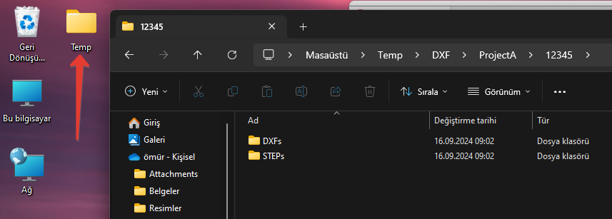

Hi Omur,
With this code i am trying to separate items in project folder. the “Fistfivechars” is actually the item number. So,
I already have a folder “DXF” inside “Desktop/temp” defined ..I want when i run the code, the code should check & if not existing then create New folder “Project_Name”. Inside this folder there should be a new folder with “FirstfiveChars” of custom property “Engraving” (This folder is for item number). & then inside this folder there will be DXF & Step files for this model.
Next when i will run the code on the next item from same project, then this will create a new folder inside same project with new Item no. (“FirstfiveChars”) & all the DXF & step files will be saved in this.
Also see attachment. let me know if above explaination is clear.
Is this what you’re talking about?
SheetMetal_to_DXF - R4.swp (307 KB)
