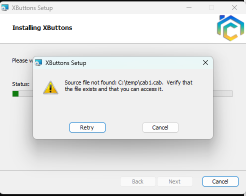

Thanks again, Jim! I tried out the installer, but I get this error message.
I tried a few different ways to make sure it wasn’t an admin rights issue. I don’t see any .cab files getting created in the directory.
Oops. Same here after uninstalling and reinstalling using the uploaded MSI. I’ll investigate.
So, the Wix installer defaults to not including the CAB file in the MSI file for some reason. I’ve fixed it and re-published the v1.0.0 release.
