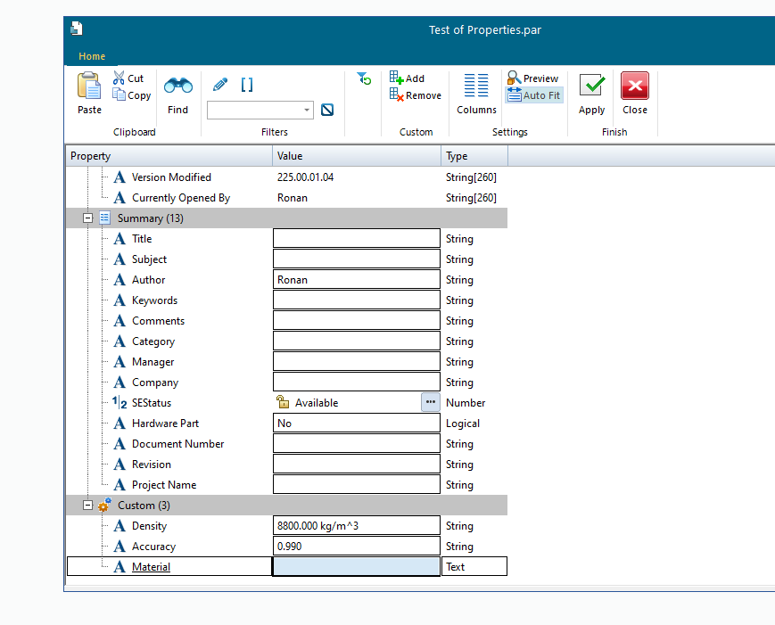

Material is already a property that is available and set when a Material is specified. You can also open Variable Table in your template, set the Filter to show Physical Properties and then set the option to expose Mass as a file property.
FYI, “Material” is under a MechanicalModeling property set that the Microsoft File Properties utilities do not show. It is however visible if using SE Property Manager. Mass once exposed shows as a Custom Property.
