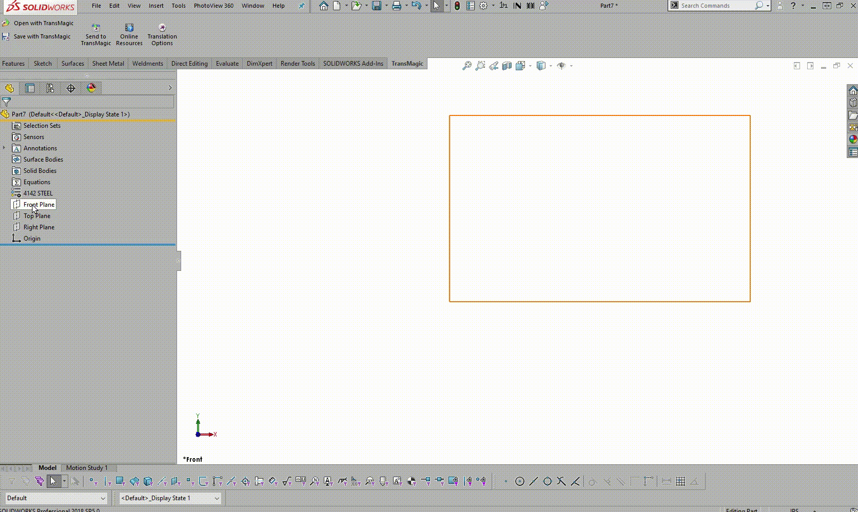

You can use the Split command upon a Body with a Reference Geometry Plane as its cutting entity, to ‘slice’ through an object. You can then use Mass Properties on the resultant body to find what I understand you are looking for.
See the attached GIF video for how I would do it in Solidworks.
Click on the pic above to view the video.
Edit: The original video has been sacked, I replaced the video with a better resolution one.
Edit2: The previous video that sacked the original video, has been sacked. It has been replaced with a better resolution one.
