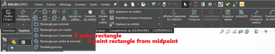

It is there as soon as I select 3 point rectangles. Unless I misunderstood your question. See video clip.

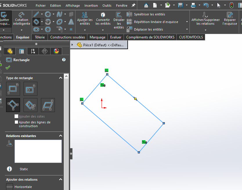

What release are you running? I’m running 2024sp2, and this is what I get as soon as I activate the 3-point rectangle:

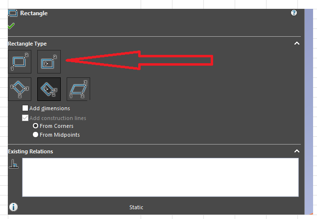

It is there, the “3 point rectangle” feature toggles the one next to it, notice the slight difference between the images :wink:
Try picking the Center rectangle

There’s an option in the dropdown menu in the CommandManager:
2024 sp5

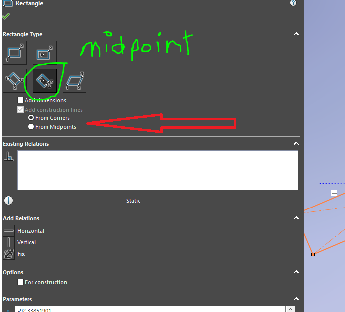

3 point CENTER rectangles. I am not sure why AlexLachance has trouble reading my mind. :wink:
You guys are getting different behavior than me. I thought it might be related to use of the command manager, where I am using the sketch square flyout off my sketch shortcut key, but that isn’t it. If I select center rectangle or 3 point center rectangle, the options do not appear until I have drawn a rectangle.
Oddly, if I select Corner Rectangle or 3 point Corner Rectangle, and then select the “Add construction lines”, the options appear, although the square drawn behaves as if it were a regular Corner Rectangle or 3 point Corner Rectangle.
