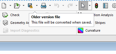

It does not give me any error messages. When I push the file through the transition that triggers the task it appears that everything runs fine and the file explorer shows the “Date Modified” as being changed to today’s date but when I open the file I still get the “Older version file” warning.

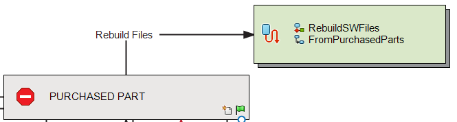

Currently my workflow looks like this:
Transition the file from “Purchased parts” to “FromPurchasedParts” in my “RebuildSWFiles” workflow.
Purchased parts DOES NOT have check out permissions. No actions are taken during this transition.
The file is then sorted and Auto transitioned back to “PURCHASED PART” in the “Dwgs - Purchased Parts” workflow. (original state).
During this transition the action to run the task “Rebuild Part Model” is taken.

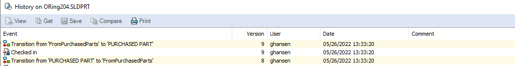

Can you confirm that the task is creating a new version of the file?

When I transition the file through the workflow and have checkout permissions enabled in the “Purchased Parts” (current state) it is creating a new version. And the last Event in the File History shows “The file was checked in!”
When I transition the file through the workflow and DO NOT have checkout permissions enabled in the “Purchased Parts” (current state) it is creating a new version. But the last Event in the File History DOES NOT show “The file was checked in!”

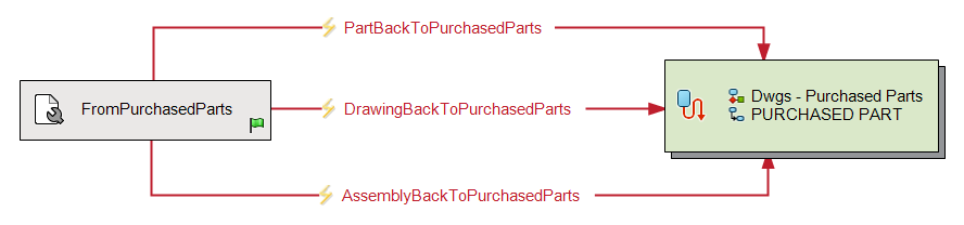

Which transition exactly are you doing the action in? Can you post screen shot of the transition and action dialogs?
  • The file starts out in the “Purchased Part” state of the “Dwgs - Purchased Parts” workflow. There are no checkout permissions in this state.
  • I manually transition the file to the “FromPurchasedParts” state of the “RebuildSWFiles” workflow via the workflow link. No actions are performed on this transition. There are checkout permissions in this state.
  • The file is automatically transitioned to the Workflow Link which sends it back to the original workflow and state (“Purchased Part” state of the “Dwgs - Purchased Parts” workflow).
  • The Rebuild Files task is triggered by this automatic transition.
  • It takes a while for the task to start and by that time the file is already back in the original state which has no checkout permission.
