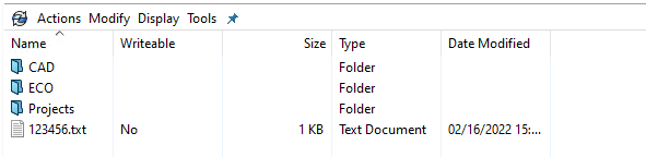

None really except the file Windows columns and one called “Writable” to indicate if you have the file checked out for write access. But since the DB isn’t connected they defaults don’t show since it can’t populate the data without the DB.
Online
Offline
Oh shock, you’re right.
I confused this with the display in the “normal” Explorer.
There you can display the content of the variable “Description”.
Is it not possible to add more columns in the PDM display in Off Line mode?

Yeah, you can’t add custom columns in offline mode. Would be nice to leave Number, Description, and Revision intact. We don’t work offline that much so I’ve never heard anyone complain about this. Most everyone has a VPN connection and a hotspot if needed.
