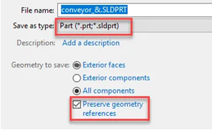

As far as multibody vs assembly. I think assembly wins in most cases. It’s much easier to work on and improve. Performance difference is negligible… except if you use Exterior Faces option! But then you are simplifying a lot, and you might want to keep a copy of part and assembly. If the assembly is huge even exterior faces might be an excessive part file.
