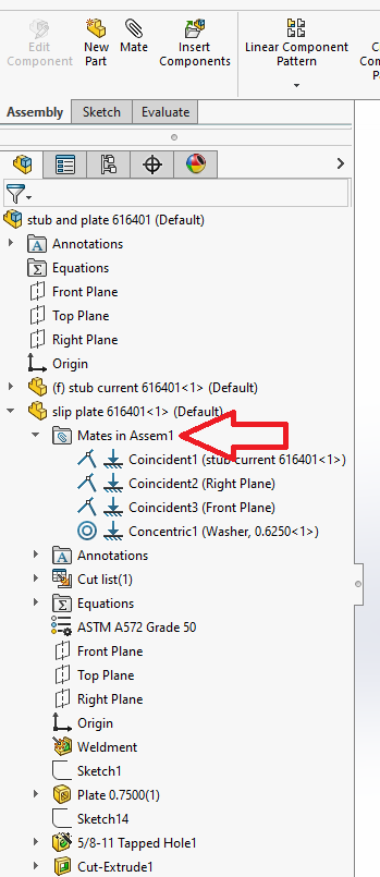

Expand the Mates folder just below the file name.
