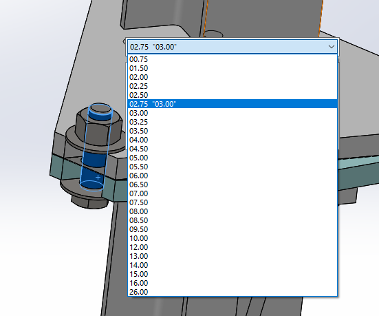

As the title states, since I’ve updated to SW2022, whenever I create a new Part configuration it automatically adds a description. Is anyone else seeing that, and if yes, do you know how to turn it off? By default it’s using the name of the previous active configuration. As you can see in the screenshot below, that can be a problem. I don’t generally have descriptions in my configurations, and don’t want to have to delete it every time.

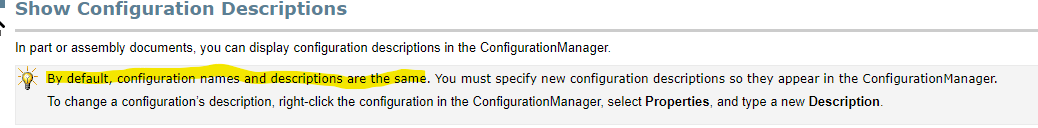

This is the only thing I can find in the help.

I’m not sure what’s going on. As you can see in the screenshot, SW automatically added that description to the newly created configuration. For me, previous versions didn’t do that.
