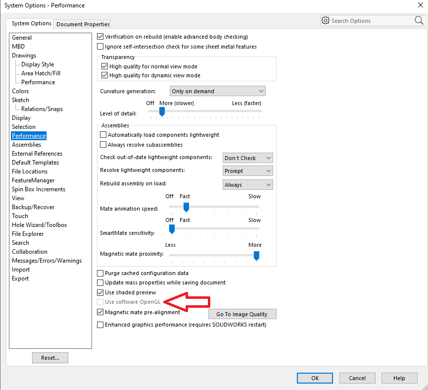

You might try having your user close all open SW files, then go to Tools > Options > System Options > Performance and select “Use software OpenGL” (see below; it’s grayed out in my screenshot because I have some SW files open). He or she may take a performance hit, but if the crashes stop then the problem is almost certainly your graphics card. I wouldn’t recommend anyone using that setting all the time, but it can be a helpful diagnostic tool.

I will try enabling OpenGL first and, if that doesn’t work, then try a new profile. This has actually been going on for about 10 months, I just now have taken responsibility for it.
