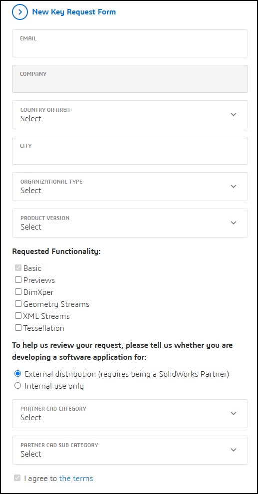

I wasn’t sure about the legality of the doc manager key for selling a commercial app. Any SolidWorks user that has a license can request a key for internal development. We’ve done it for years and you must request a new key for each version.
Reading the terms on the request site, it appears that you cannot distribute software using the doc manager api unless you are part of the partner program.
https://www.solidworks.com/support/subscription/key-request/
