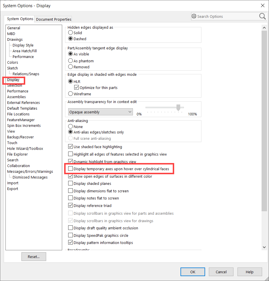

SW 2022 SP2 - First Thoughts
Problem solved in SP2.0.
Alin,
As you probably know, I was one of the people yelling loudest about the initial implementation of this “enhancement”, but since they modified the behavior to build in the delay I’ve left that option turned on so I can use it occasionally. Before the delay I hated it with a purple passion.

You have to turn off Instant3D
Thank you, Tera! This helped me a lot! ><
