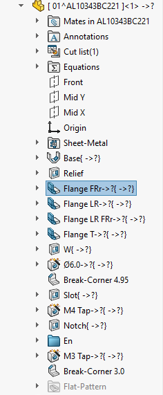

Is there anything wrong with Pack & Go in SW2022 SP2?
It seems I can not Pack & Go an assembly. The task ends without any error, but the new assembly is full of broken references. I really hate SW.

yes, Pack&Go does not update references in new saved assembly. Supposed to be fixed in SP3.0.

Pack and Go works fine in SW2022, as long as you don’t try to re-name components as part of the process (or at least it does for me). Fortunately, since we got the ability a few years to re-name components within an Assembly that’s not as big a deal as it would have been otherwise.
Right, Glenn. In your case it doesn’t seem to be a big problem. In our case, it is a huge problem, costing us many extra hours. I am staying at SolidWorks 2019, postponing upgrading. Amazed by the number of issues in the last three versions of SolidWorks. grumph

All components are virtual. So there’s no renaming.
Can you test if pack & Go has any problem with virtual parts?

  1. It worked fine with a virtual Part.
  2. Yes, I’m using SW 2022 sp 2.0.
  3. Why can’t you re-name virtual Parts from the Assembly tree?
I don’t. Not that I can’t. I simply select pack & go, then Replace the old name to new name (using replace all).
The assembly has 158 parts. All sheet metal. 102 parts are OK. the rest ends up with broken references.
No matter how many times I repeat this, the same result.
I’ve been using Pack & Go regularly, never had this problem before.
Thanks for testing and letting me know the result.
TeraDid this work in a previous version? We are on 2019 and it seems I ran across this before and it was related to virtual components not updating. Problem affects assembly renames in PDM as well as the “update references” code cannot ‘reach’ into virtual components that are embedded inside an assembly file to update the in-context links.
I find several SPRs on this…all fairly old.
Back around that time I had problems with virtual parts getting left behind when doing a Pack and Go. I didn’t use them often, and even then it was usually just one per Assembly, so I stopped using them altogether.
The problem with re-naming files during the Pack and Go operation is new with SW2022 (at least I didn’t have the problem with older versions).
