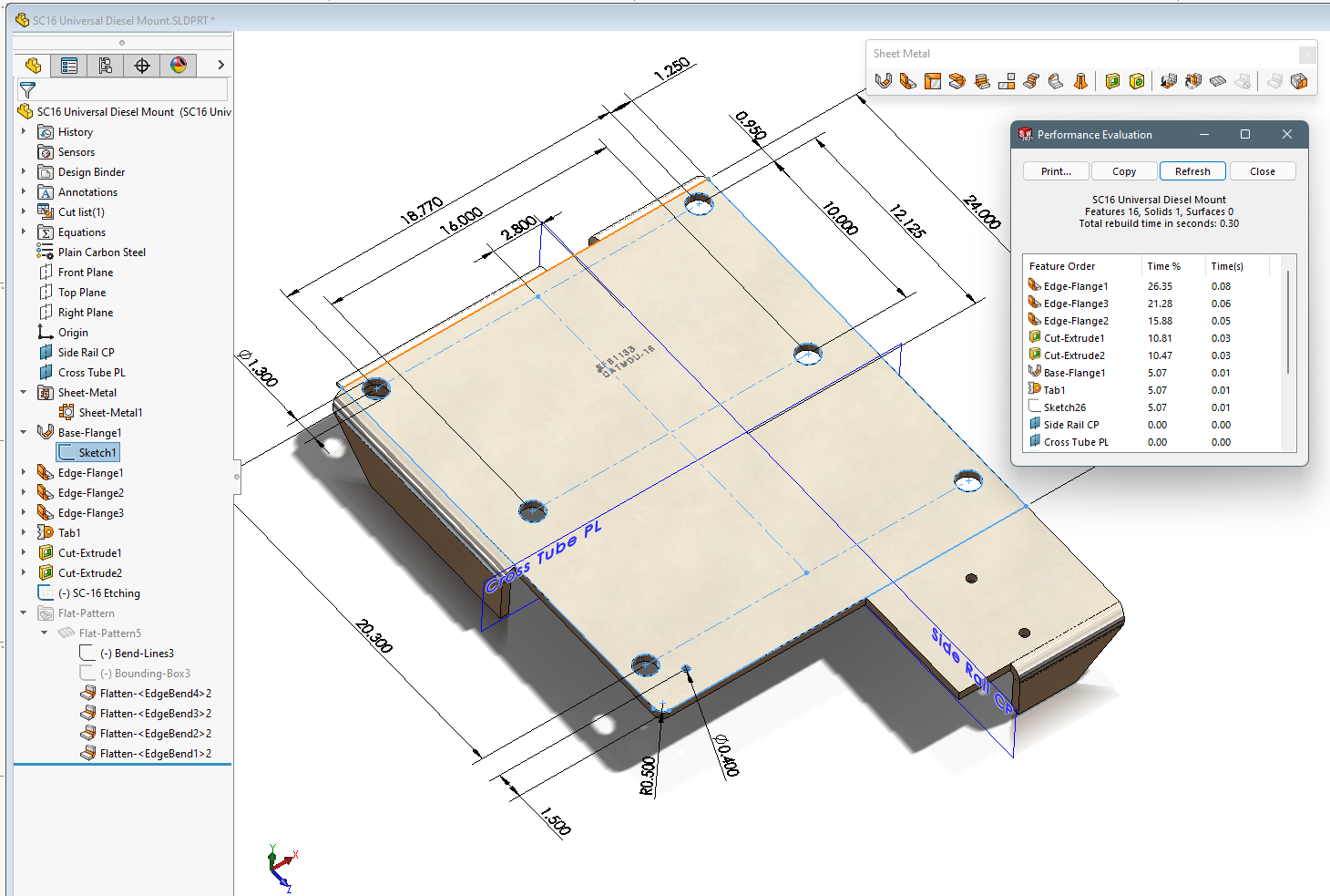

Has anyone ever seen this before? I have a single sheet metal part- one body…fresh (2018) template…VOR is off…no errors…no massive memory leak in Task Manager. But when I edit the Base-Flange sketch it takes 10-15 seconds from selection until the context menu with relations appears. It is only this part and no others and it was doing the same thing yesterday even though my computer rebooted since then.
All selections and dimensions are slow in this sketch, but the real timesucker is Ctrl selecting multiple entities. Try waiting 10 seconds until you can pick entities to relate…it’s so long that it’s easy to forget what I was going to do! <()>

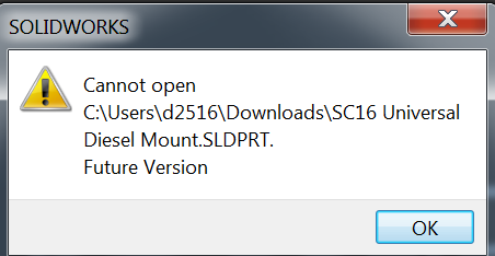

??? This is what SW 2020 says:
Nearly instant in 2021 SP3. fwiw.
That’s what happens when you’re living in a cave. It’s a 2021 version.

I just have 2019 installed so cannot open, you have other similar workstation to try that file on? Is the file local or on a network? It does kind of sound like corrupt install. Then again, it could be that you’re not running certified hardware/drivers…

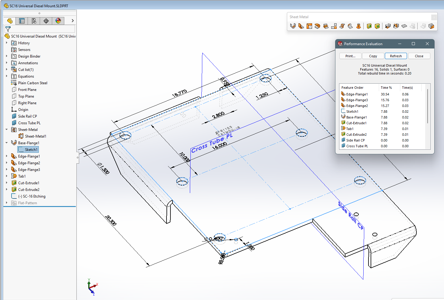

Here it is in 2022sp0. No issues that I can see.
CPU: 17-9700k
RAM: 16GB
Graphics: NVIDIA Geforce RTX 2070 super 8gb
SSD: Samsung 970 EVO M.2 500gb

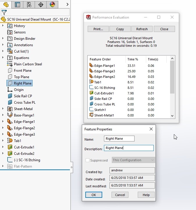

Here is fine too. SW 2021 SP5.1
hmm,.. seems fine. your resolve time is/was 0.20sec? (that’s a issue?) (mine, a slower/older machine resolves in 0.30sec)
