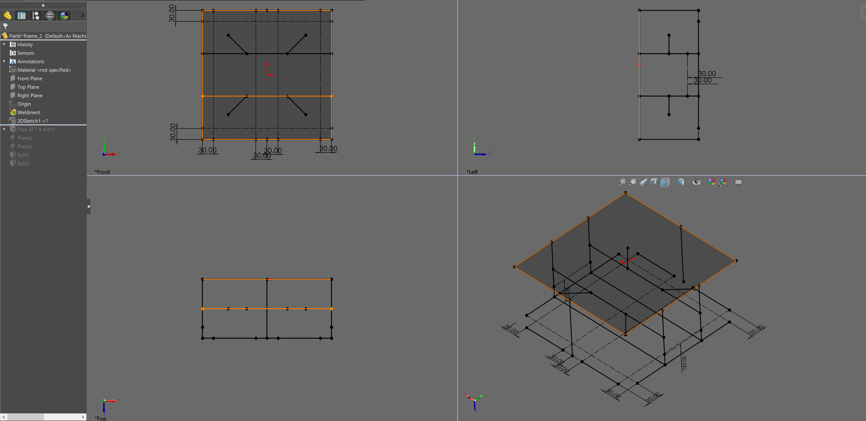

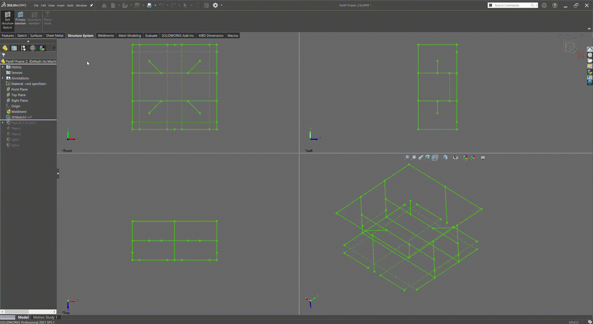

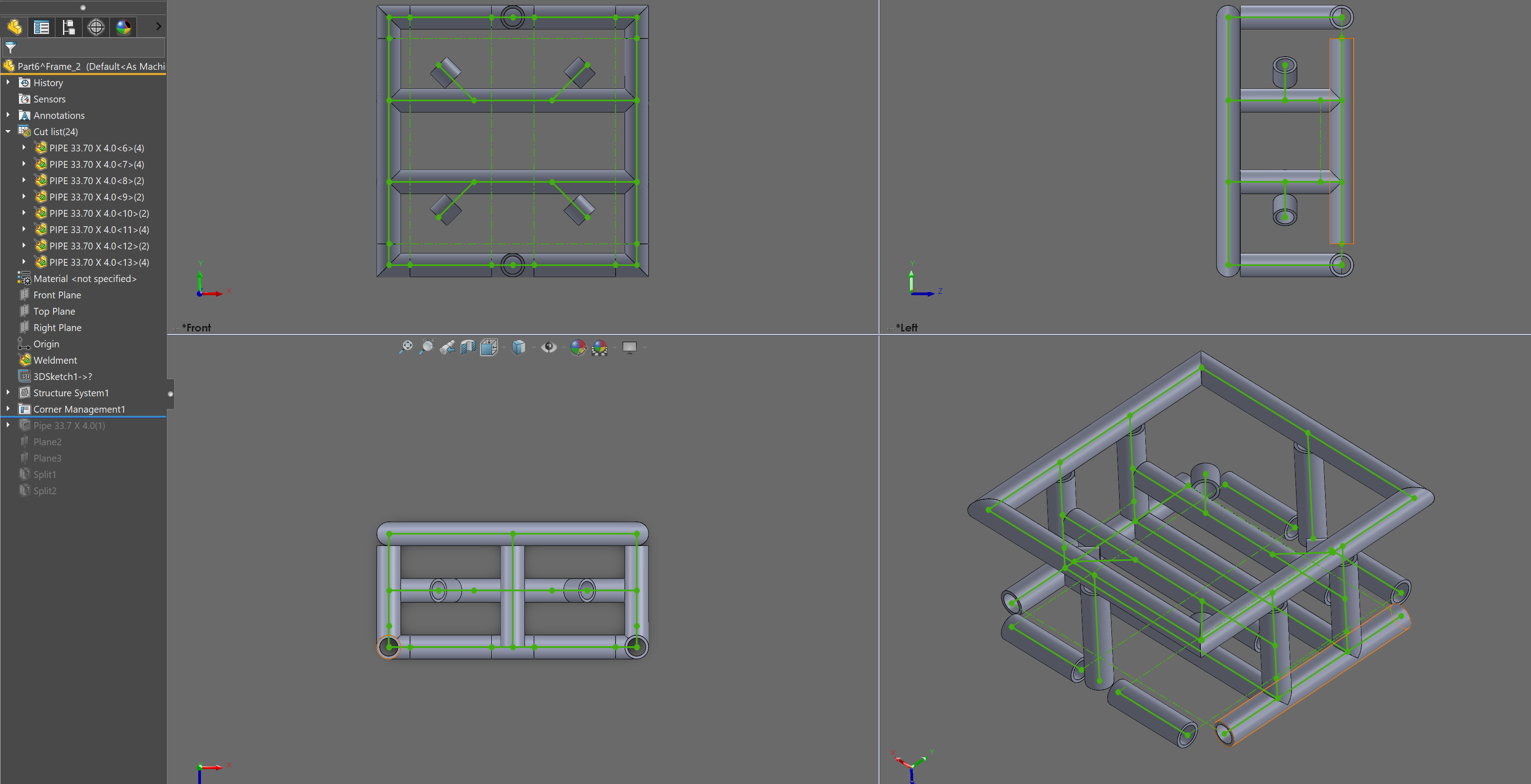

Structure System is able to create everything with box selection, so it’s faster than Structure Member in that way.
Additionally another option is add construction geometry in the 3DSketch and trim the unwanted part, this way you are able to edit it later. Although 3DSketch has some trouble depending on the way you set relations and stuff, sometimes it jams.
Structure System.SLDPRT (448 KB)
Thank you for taking the time to try this out. There are missing files in the Assembly you attached, could you please upload a full Pack&Go, so that I can properly understand how you made this?
I can’t get them now. They are the same files you send, I just modified the assembly and saved with another name, if you paste it on the same folder will work.
Basically I just created a new virtual part, made a 3DSketch and Convert Entities from yours, then made the Weldments, two Planes and used the Split feature. I just did a quick demonstration to show the tools to you ^^

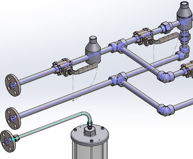

Words needed. In the meantime, here’s worth a few thousand. 6/10/22 Edit: More words added. I think it needs an intro and conclusion still.

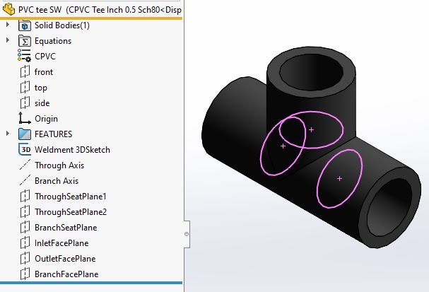

Three Tees:
Each fitting part has a Weldment 3DSketch which converts entities upon the inner edge of the pipe seat. The colors differentiate plastic pipe, metal pipe, and metal tubing. The circle or Arc is not the valuable asset in these sketches. The valued reference is only the center point of that arc or circle. The first two parts contain very many configurations for sizes, materials, ratings, and connection types. The third part is a single configuration purchased product. Each Tee is oriented the same, with its through axis on the X Axis and the branch axis on the Y Axis. Each one has reference entities of Axes and Planes, named exactly the same where its application matches (i.e., pipe or tube). All reference entities (except the Origin for some reason) are available in an assembly when the component is lightweight. The 3DSketch is only available when the component is resolved. This detailed attention to components is critical for later processes here to function robustly and interchangeably. This component definition is also a parallel process to the requirements of the Routing Library Import Wizard, but it is in my own manner for my own multipurposes. The 3D Sketch entirely replaces RPoints which are used in Routing, and carry no associative size variable.
(added)
Due to the exactly named and defined reference planes across all similar objects, I am able to handle two objectives of Routing with little additional effort. Because all mates are ideally defined exclusively between reference entities of the components, I am able to dynamically replace all plastic tees with compression tees, or socketweld metal tees, for example. Sometimes I change the size of a pipe train by exchanging a single-configuration component with another single-configuration component. Other times, I can select a different size from within a multi-configuration component. When I change size by component configuration, the secondary derived pipe or tube does not require its sketch relations to be reassigned.
(added)
Here is the one hang-up that does not happen automatically. When changing from one component to another, the sketch point of one component does not have its relation updated to the similar sketch point in the new component. Therefore, after the component is replaced, Errors will pop up within the 3DSketch of the virtual Pipe/Tube component. All that is needed to resolve this is to use Display / Delete Relations tool within the pipe/tube 3DSketch to delete dangling Relations, then reattach the endpoints of the sketch to the similar sketches in the new component. Then it can rebuild and resolve its errors.

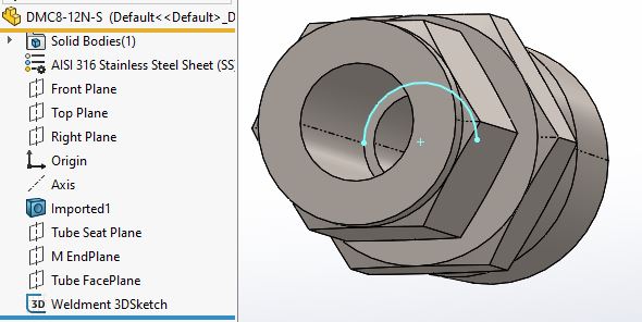

One compression adapter:
You can see here that the manufacturer-provided imported geometry does not have a circle at its seat. Sometimes components have a face split along its entire length. This matters nothing to me, because the Arc in this sketch has the same center point to refer to as a circle would. However, if the imported geometry is flawed so that it is neither an Arc nor a Circle, then it will not have a center point to go with the converted edge. In these rare cases, I may define two equal colinear lines across the seat and On Plane to a primary reference plane, in order to create an actual point at the correct location. End points work just as well as center points. Midpoints are a pain in the assumption.
Arrange your assembly with mates between adjacent fittings exactly as using Axis coincident to Axis, FacePlane distant from FacePlane, and a primary reference plane parallel to something. Elbows sometimes need the same constraints, but sometimes only two Axis-Coincident mates will suffice. Applying all mates in all manners will overdefine the assembly. If applicable, I may define a Global Variable in the assembly to represent visual pipe length as the default value for face distant from face mates, with other values applied as desired, such as where a support or hardware will land upon the pipe. I use 2" spacing on socketweld, 3/4" on solventweld, 1/2" on compression, and no GV for threaded.

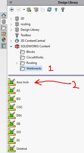

For your weldment profiles, you don’t need custom profiles. You should be able to retrieve a whole package of standard profiles here:
You will find many sizes of SCH.40 and SCH.80 pipe there, under Pipe (Structural).
