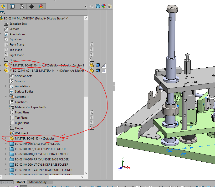

Here is my assembly with the Master Models in it:
What you are seeing at the top of the tree is the Master file, which has my customer part and my SSP in it.
Then, each of the Master Models has, as the Master file inserted into it.
Then everything is built into the that master file. I made a Master Model assembly like this only to be able to switch between my different Master Models quickly. Nothing is References in context with this assembly.
Please note: For duplicate parts, I only put 1 body of that part into the Master Model and use a derived sketch to represent the other positions. Then, at the assembly level, I position instances of that part as needed.

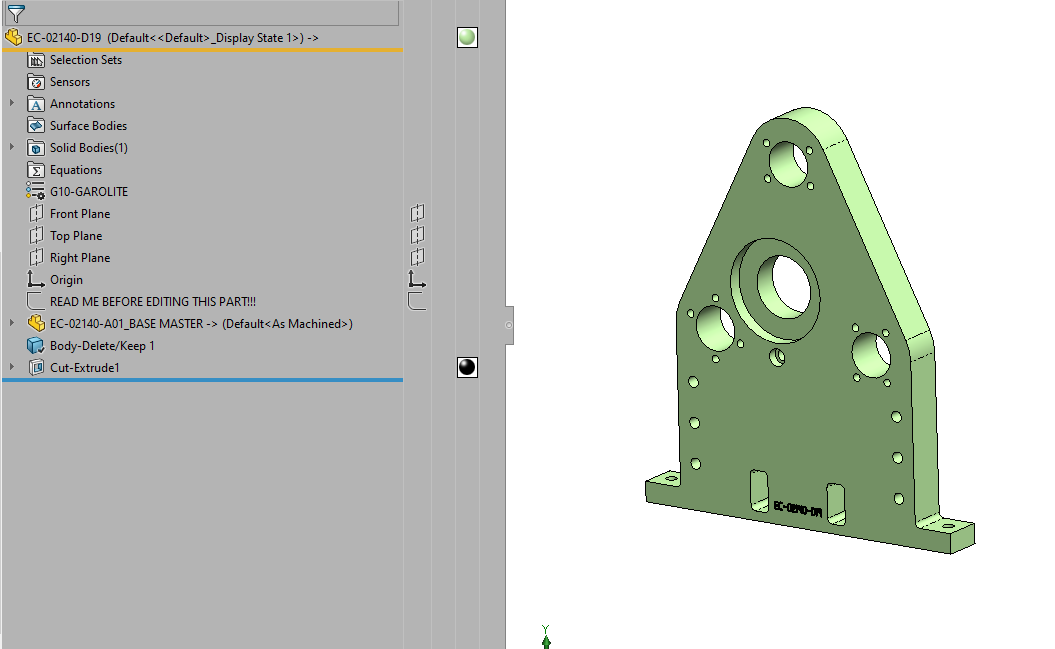

Once the design is complete, I create a new part for each of the bodies represented here. Then insert the appropriate Master Model into the part (using Insert…Part..) (I do it this way, because, as far as I know, this is the only way to pass through Hole Wizard data)
When you open one of the final parts, you see this as a Feature Tree:
As you can see, I have inserted the entire Master Model into the part, then used the Delete Body “keep function” on that body (this is because, if I ever add any more bodies to that Master Model, this part file will still only show that 1 body).
Then create my custom properties for that part and add anything specific to that part (in this case, the engraving that is tied to the Custom Properties for that part).
