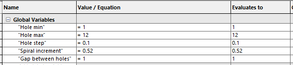

  1. Since it is difficult to predict the final shape, first I extruded oversized base plate, enough to experiment on.
  2. Then I defined some global variables to reference later on. Pretty much self-explanatory. “Spiral Increment” is how much each hole offsets further away from the center compared to the previous hole. This could have been expressed as a spiral pitch, but I’m not that good with spiral math.

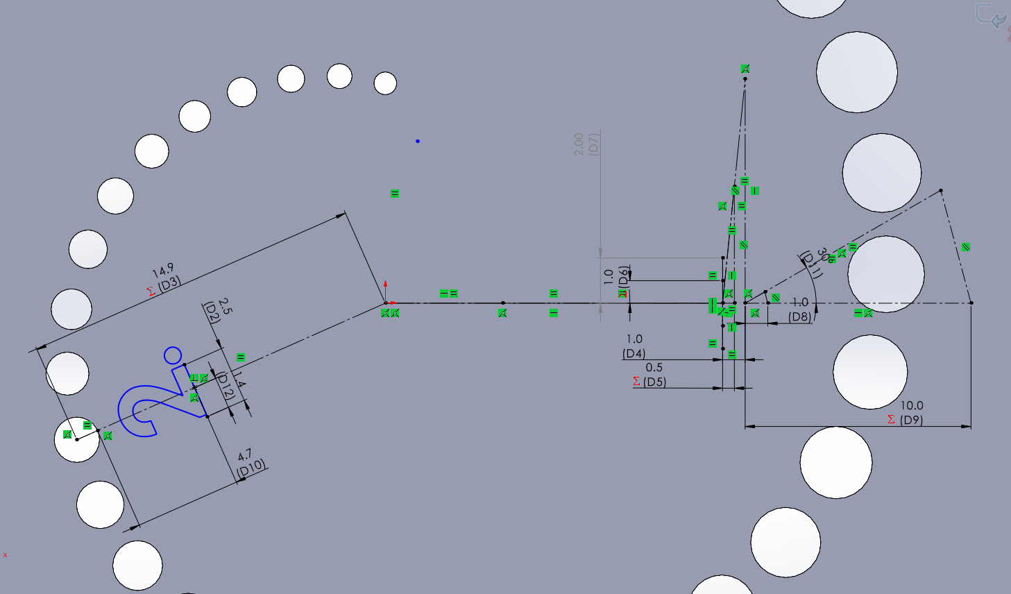

  5. Holes are now complete. Now, the really crazy part - parametric markings. They need to be built with Sketch Text, this text has to be patterned, and each marking must be right next to it’s corresponding hole with more or less consistent clearance. There is a clever trick to do patterned text - have it reference a dimension, and then modify that dimension with Instances to Vary (learned it from here: https://www.beacon-india.com/incremental-text-pattern-in-solidworks/). So basically there has to be a dimension inside the text sketch that has the hole size.
    Now here’s the bummer… Turns out, when feature with a sketch is patterned, equations inside that sketch are not updated for each instance. Basically you can only reference some static values from outside the sketch, and that’s it. This means that the equation that turns text offset distance into a hole number, must be solved geometrically. Enter Descartes geometric division/multiplication triangles.
    This thing took me ages to get right. Lines on top of lines on top of lines and a mess of relations, all to get a simple number of the hole. Unfortunately, I had to start at the second hole marking, because geometric solving won’t work for the first one - some lines become zero-length. First hole marking had to be done in a separate feature, which is fully referencing this one. Sketch positioning had to be also solved with geometric equations, to offset that text as the hole size increases.
  6. And then pattern with some more equations, incrementing text offset from the axis just like for the holes to make that sketch work it’s magic.
