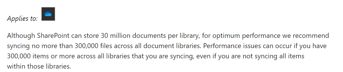

300 000 files according to Microsoft. I use Onedrive
