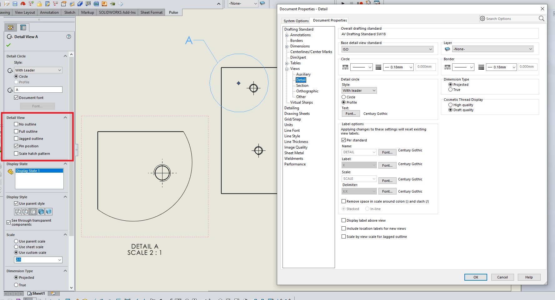

. . . and then there’s one of my biggest pet peeves. Most of my drawings have anywhere from two to eight detail views. I always use the “with Leader” option. And I have had to change it from the default every stinking time for 13 years.
Amen
Easy fix… Just change your base detail view standard to GOST, then manually change every single other option on the page back to whatever your actual standard is… :laughing:
Oh… and then save your overall drafting standard and update all your drawing templates.
I don’t understand why SW hides some of the options inside the drafting standard and doesn’t let you manually change them…
I find it interesting that the GOST leader is different to the leader you get when you set any other standard to “With Leader” (and I can’t see any setting to toggle between underlined vs adjacent leader).
Gost gets close, but it has the letter underlined instead of pointing to the center of the letter (which is what you get when you change from “Per Standard” to “With Leader”, and what I want).

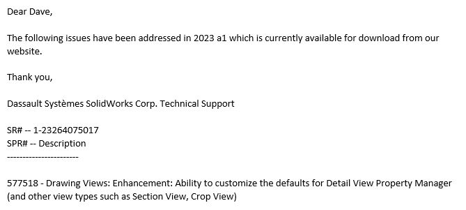

Just had an email saying this is now available as of 2023 A1 so there’s a possibility they’re actually right, just not communicating it very well. Will need someone with access to '23 to verify it though.

I got a reply to my Idea on the other forum yesterday from a SW employee verifying that this has been fixed with SW2023, and she said that it was a late enhancement so it wasn’t included in the What’s New documentation.

Just installed SW23 SP0.1 and you can indeed set Detail Views to use “With Leader” in the Document Properties, huzzah!
Unfortunately there’s no way of setting any of the parameters in the “Detail View” portion of the Feature Manager in Defaults (one for the TTL) but at least some progress has happened.
