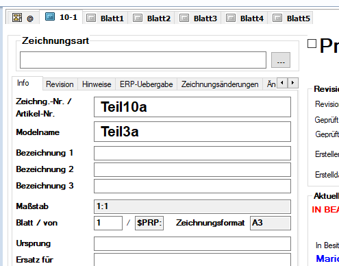

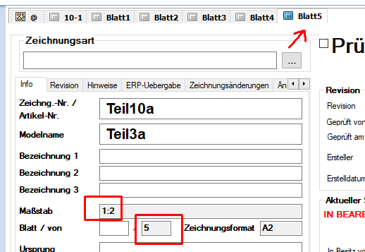

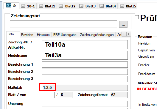

Since the update of SolidWorks PDM and CAD to version 2020 I have the problem that I no longer have reliable data on the data card of the drawings. It is about the indication of the current sheet and the total number of sheets.
I’ve now played around with CustomPropery and $PRP.
e.g.
Block name = $PRP
AttributeName = SW-Current Sheet
Extension = slddrw
Either nothing or something wrong is displayed …
Maybe someone has another idea?
Cheers
Mario
