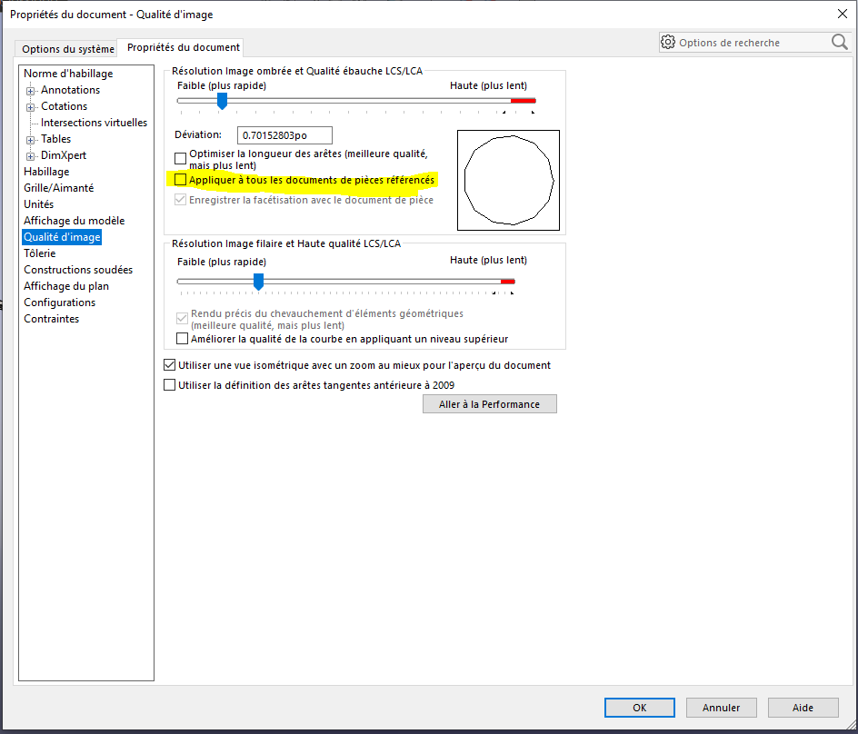

You could do a complete check-out on the whole assembly and then use this setting to apply the setting everywhere: (Apply to all referenced part documents)
https://help.solidworks.com/2021/English/SolidWorks/sldworks/HIDD_OPTIONS_IMAGE_QUALITY_display.htm

The only issue I have with “Apply to all referenced part documents” is this:
Let’s say I open my root assembly. I then set image quality to 20% & check the “Apply to all referenced part documents” and it successfully applies that settings to all the parts; okay perfect. I also have all the parts checked-out. At this point I perform a save operation.
However if I close the root assembly & open a sub-assembly or a component belonging to the root assembly then it opens with the settings it was last saved as (meaning the 20% only takes effect on these parts when I open the root assembly).
So in order to have all the components at 20% permanently I need to apply that settings at root level; but then open everything and do a save operation.
