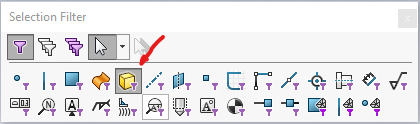

SolidKeke Hit F5 to turn on the selection filter toolbar. Toggle “Solid Body”

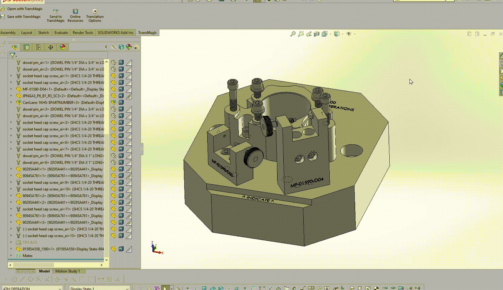

CTRL Select the 1 face or edge of each of the parts you want to copy.
RMB select Isolate. This will temporarily hide all other components.
Box select all shown components.
CTRL C
Go to new assembly.
CTRL V
Click the GIF below to see an example of what I mean.
(FYI, this ONLY works with components that are on the top level of the assembly. it will NOT work with components that are buried in sub assemblies.)
