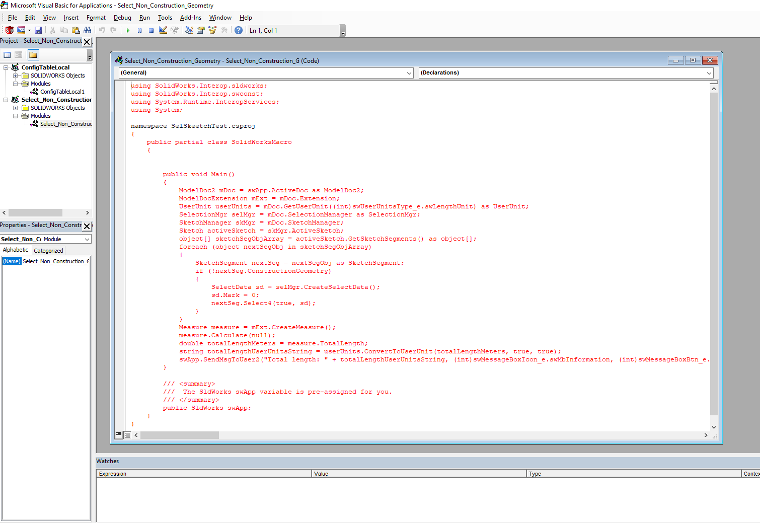

I’ve just tried pasting that in and it doesn’t seem to like something as it’s coming up as a wall of red text;

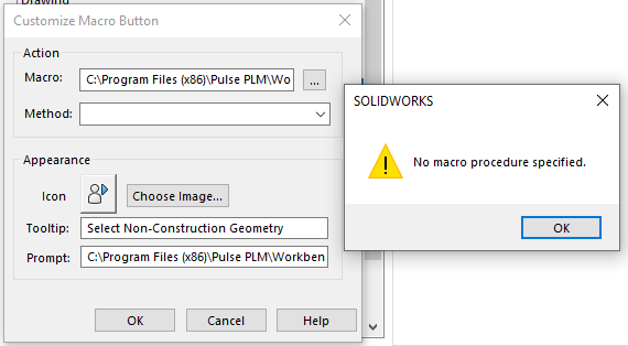

And when I try to add a button to the UI the following error message is returned;
Any thoughts?
Your macro is named differently so the namespace is messing things up. Just create a new macro and paste the code from my Main() method into your Main() method instead of cut and pasting the entire thing.
I fear I may be misunderstanding something fundamental. Have pasted in from Main() only and it’s still a flood of red;
Indeed. My macro is a C# macro. You created a VBA macro and tried to paste in the C# code, which won’t work. When you create a new macro, do you have the option of ‘SW VSTA Macro’ in the ‘Save as type’ drop down?
