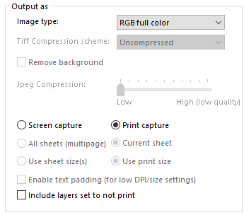

The marketing department has requested I provide them information in the PSD (Photoshop) format. I’m struggling to get decent results and could use some help. (The solidworks help file on saving as PSD is lacking in information.)
There are 2 options:
When I pick screen capture the resolution is terrible.
When I pick print capture, it tries for a while, and eventually I get this useful error message:
If anyone has any tips on saving a high quality photoshop image please send them my way.

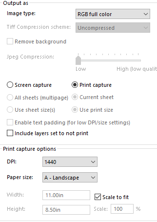

What is your Print Capture Size?
I had the DPI maxed out trying to get the best image possible. It is now set to this and appears to be working. (I wish I could enable the “all sheets.”)
