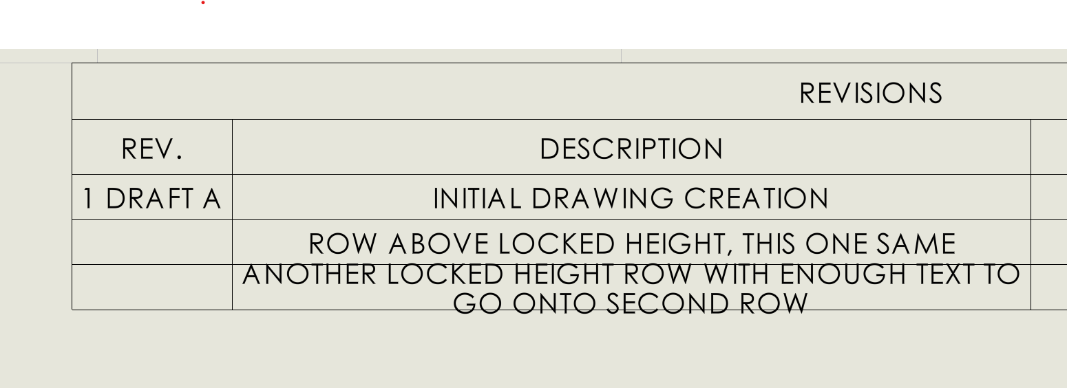

I am trying to understand what is controlling the row height on my revision table.
For the row with 1 DRAFT A, I double clicked and the height adjusted to be a tighter fit around the letters. I added a row using insert row (not insert revision). That got me 1 DRAFT B which was back to the row with extra space. I inserted the row for 1 DRAFT C and double clicked it to get the tighter fit. I added the row for 1 DRAFT D and stretched it to be larger. (If my text had gone to more than one line, it would have adjusted height.) When I added the next row, it was the same height as the row for 1 DRAFT D. If I go back to one of the rows where I have double clicked to change the height and change the text it goes back to the single row height like I have on 1 DRAFT B when I exit editing the text. Any ideas what to adjust so that my rows as they are inserted will be the tighter fit and not change when I edit the text?

Have you tried locking the row heights? Once you lock them, any new rows added are locked as well and are defaulted to the same row height.
Solidworks has had LOTS of issues with row heights jumping around in Solidworks. They added the ability to lock row heights a few versions ago and it definitely helps.
It always takes the last row height for a new row. I don’t think you can change that setting except with ‘Lock Row Height’ as DanPihlaja mentioned.
Also - sometimes SOILEDworks won’t let you mass-adjust the row height anymore. You have to grab the right bottom corner to adjust all cells & then you can mass-adjust again.
I looked into changing it with a macro - but there is not really an API command for it, afaik. I think for a working macro you’d have to first calculate the smallest possible row height with the API & then change it for each row.
Lock row height didn’t work on the table I originally used for my example. That one was on an older drawing that was created with old templates. It did not show the lock symbol when I selected Lock Row Height. It just popped up a window with the option to adjust the row height. As I wrote this, I went back and tried it again, and just to make me feel silly, it started working. o[
When we went to SW 2020, we created new templates. I made a new drawing that used the new templates. This allowed me to lock my row height. As usual with SolidWorks, if you fix one thing, something else doesn’t work the way you want. We will have to unlock the row height if we go to more than one row of text. I’ll have to talk this over with the others in my group and see if it is worth trying to have the slightly shorter table.

I know it will take up more room. But you could lock the row height to account for any possible 2nd lines. This way, you will have extra space for 1-liners, but it will be enough for 2-liners. My guess is that 3-liners are rare.
This is likely linked to the fact that the Document Setting for Table Vertical Cell Padding is ignored by SolidWorks Drawings and has been for well over a decade. I just reported this bug (again).
