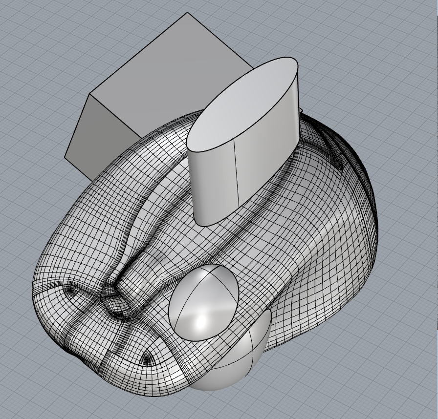

What I did so far:
Recently I have been using the Rhino7 trial and testing some SubD and Lattice in Grasshopper; there’s QuadRemesh that converts Mesh to SubD and later it’s possible to convert it to NURBS (plus Rebuild the surface etc). Anyone using Rhino for RE? For what I checked it’s cheaper than most SW RE Add-Ins…
Sharing the results from today. I got the this scan from last week Faro’s training:
After cleaning up the noises and trimming the borders I used Magics’ ShrinkWrap to patch and reduce the polygons:
Then I imported it to Rhino, used QuadRemesh and (convert)ToNurbs. Ended up with 110 NURBS surfaces, (which would be better to Rebuild to reduce the amount):
\*STL, SubD and NURBS
The final result in Magics again:
Some Booleans, because why not? lol
 ![05.png](https://forum.cadmunity.com/uploads/default/original/2X/d/d696592d21e319c5ceb1297ea83f2525b7bf768c.png)
What do you think? Is Rhino worth buying for it?
We did not scan any machine parts during the training, still my main worry is working in SolidWorks. I will try to find some pieces to scan this week.
Yes, it’s worth it. Rhino3D is one of the best overall 3D utility tools I have ever owned.
Also.. the other alternative is Power Surfacing or Power Surfacing RE for SolidWorks.

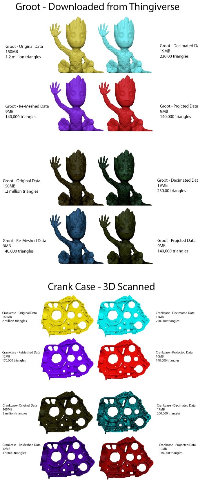

So when selecting mesh areas to then convert to geometry, yes that starts to really get into full RE. But there are levels in-between needing Design X or Polyworks and Faro’s software. Especially if maybe just needing to convert the data from a Mesh to BREP/NURBS.
I can say that zBrush does a better job in decimating geometry than ANY of these other softwares. When I say this I mean both in terms of reducing polygon count AND keeping the detail of the model and also reducing file size. (Geomagic Wrap, Magics, Design X, Rhino30 or Polyworks.) And here’s something that zBrush does that the others miss out on… a duplicate of the original high polymesh can be made, then decimated, and then reproject the details from the high poly mesh onto the low poly mesh. This last part is basically the process of that is more than just shrinkwrapping it is physically pushing the low poly geometry so that it better holds to the higher poly geometry.
In this last example this is a HUGE area that Rhino3D is missing out on. Once the geometry is converted from a mesh to BREP/Nurbs, there’s no ability to have it hold a tighter tolerance to the original mesh. So while it does convert it there can be quite a loss of detail. So then one might say that upping the detail size/polycount of the conversion might do the trick and Rhino3D can really take a huge hit in performance when trying to achieve the same results that some of the other routes achieve with much less overhead.
I would NOT recommend the Geomagic Wrap for Solidworks Plug. Yes you are correct in that Power Surfacing RE is not doing full feature recognition in the same way as Design X. What it is helping to do is convert the data so that you can use all of the Solidworks functionality to then do that conversion.
I’ll try to run a few examples and show some screen shots to post later in the week.

Here are some screen shots showing some side by side information about scanning and details.
 ![Mesh to CAD Side by Side.jpg](https://forum.cadmunity.com/uploads/default/original/2X/0/080644c17e017d632cc7d7e8b34fa299df1496cc.jpeg)
[/quote]
I never used zBrush, but I can agreed to that. lol
When I was checking Blender for decimating meshes the results were much better than using CAD software. Nevertheless, for scanned meshes with many holes and noises I wasn’t getting good results, hence I switched to Magics since I was looking for a fast and reliable semi-automatic solution. (although Magics is a pretty expensive software too, but we have it due to the Build Processor of our printer)
Guess I will check Blender again and search for the equivalent zBrush tools. It is the Decimate Master plugin, right?
\<LINK\_TEXT text=“[https://www.youtube.com/watch?v=bhbp-v2](https://www.youtube.com/watch?v=bhbp-v2) … GTutorials”\>[https://www.youtube.com/watch?v=bhbp-v2SPbY&amp;ab\_channel=RaveeCGTutorials](https://www.youtube.com/watch?v=bhbp-v2SPbY&amp;ab_channel=RaveeCGTutorials)\</LINK\_TEXT\>
I hope Blender has this brush to preserve the mesh lol

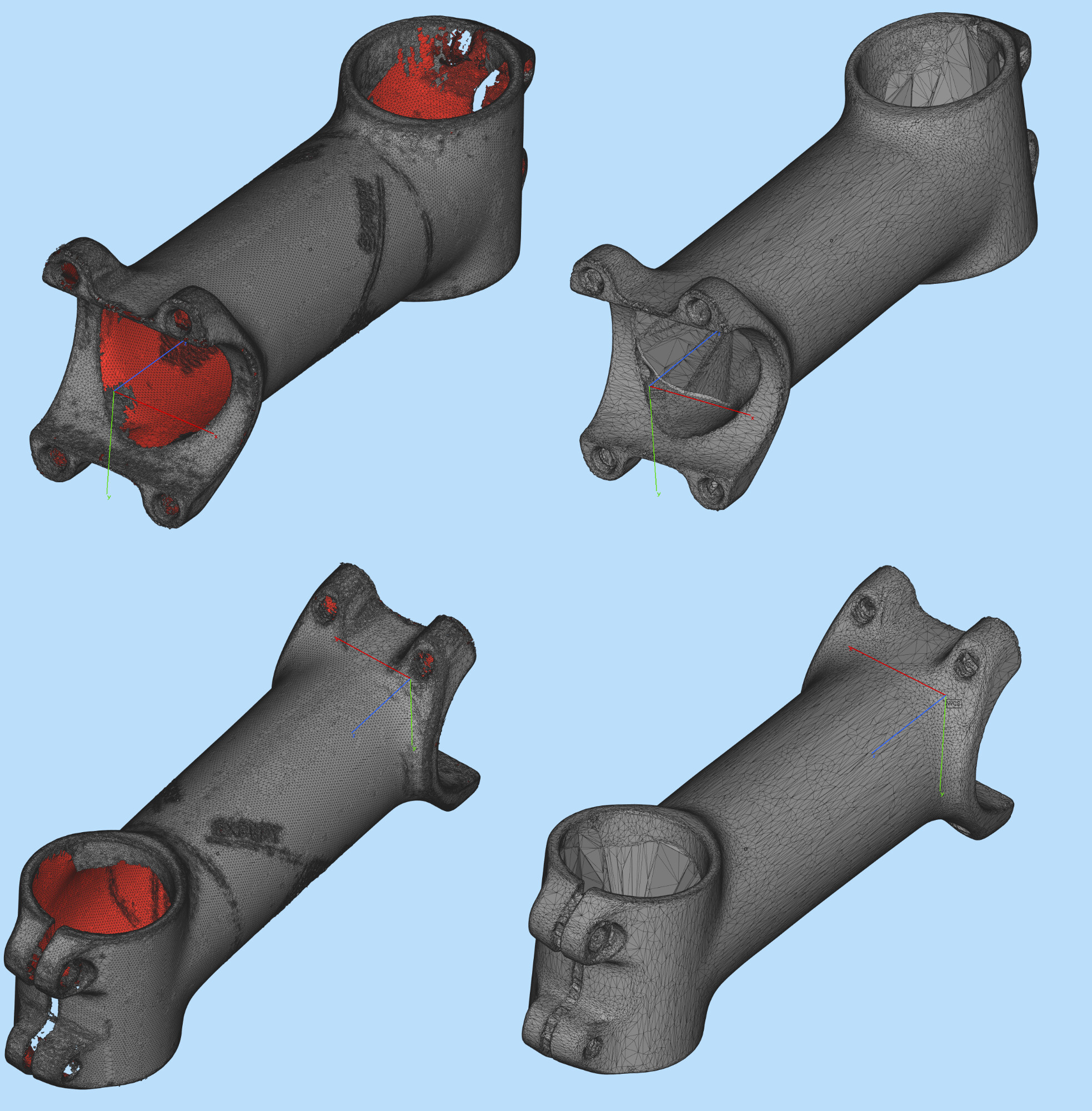

Here are my last results from December. I had to deal with other stuff this year and stopped the Scan tests 😕
Bike Steam
Before and after Magics:

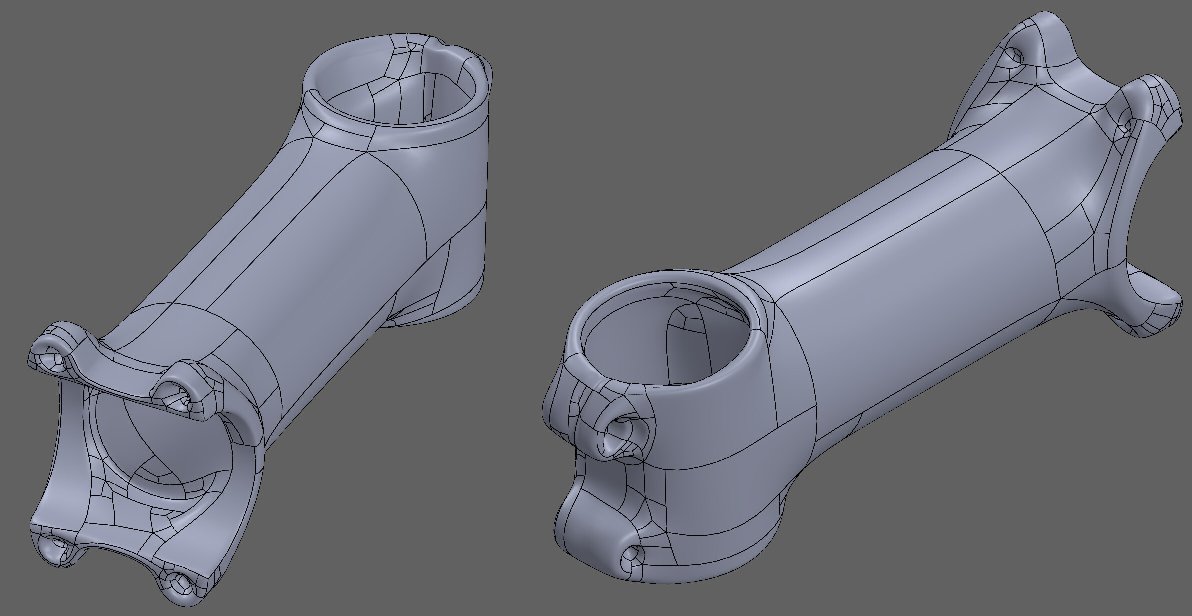

Rhino .Step in SolidWorks:
Final Result:
 ![image.png](https://forum.cadmunity.com/uploads/default/original/2X/e/e7719179f70c2d143e286efef308767e0e38a921.jpeg)
\*This one I actually did not import the mesh in SolidWorks. I was measuring in PolyWorks and making everything without references.
It was pretty painful. lol

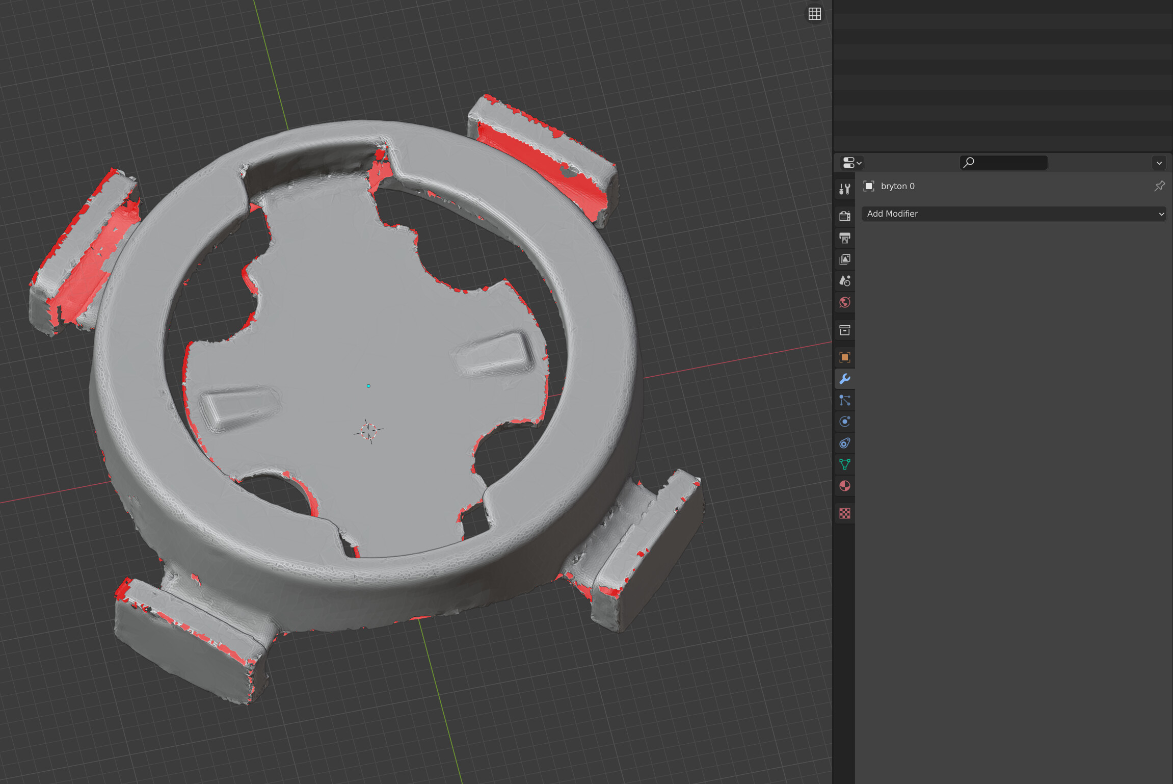

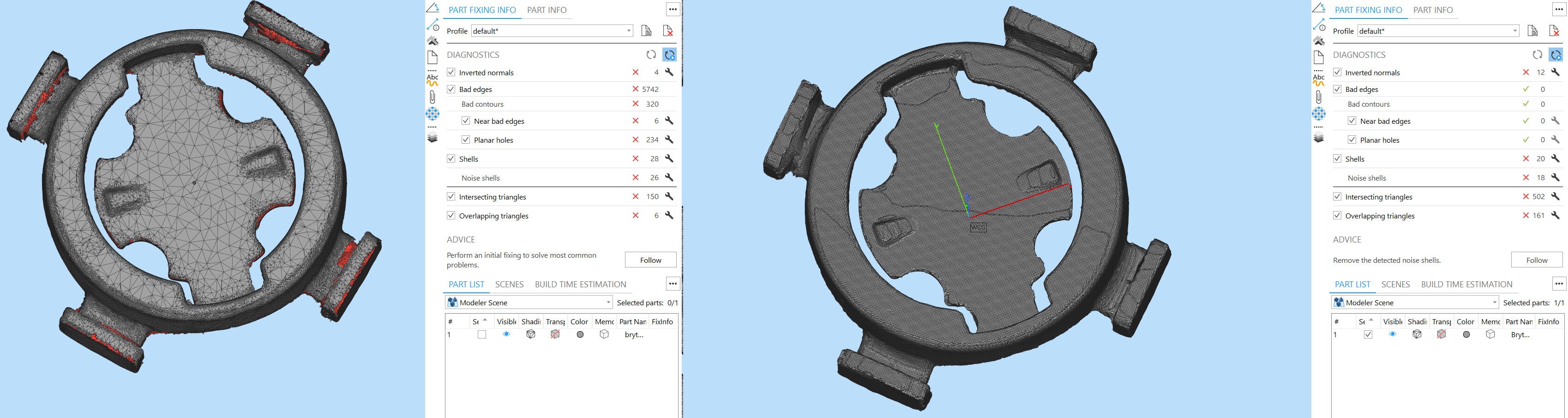

Garmin Mount (Cycling Computer)
 ![image.png](https://forum.cadmunity.com/uploads/default/original/2X/b/b5fa51e4a4fdfd010e5100828b39ab9f9fc9242c.jpeg)

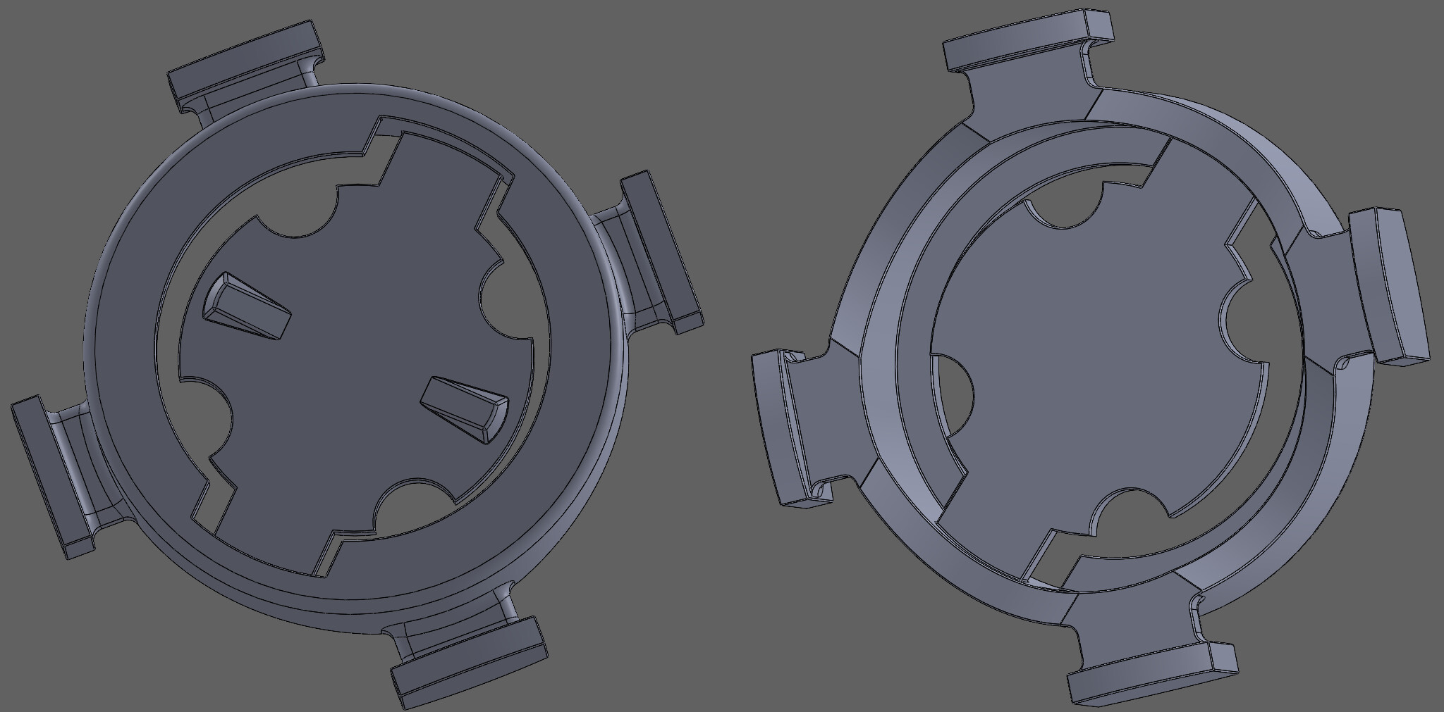

Final result:
 ![image.png](https://forum.cadmunity.com/uploads/default/original/2X/8/8bcbed4255c144594e15bb5a7e821a87976b268b.jpeg)

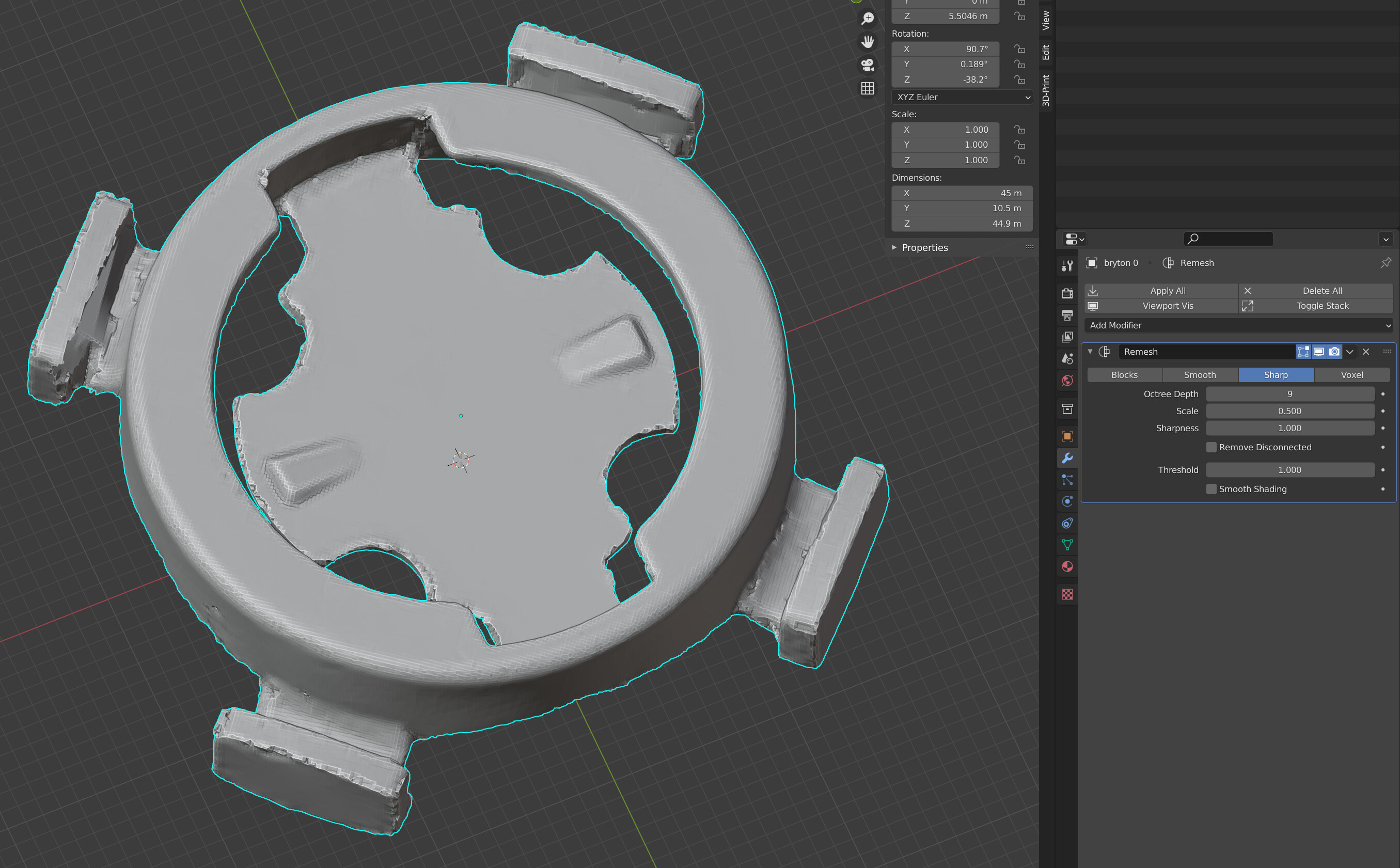

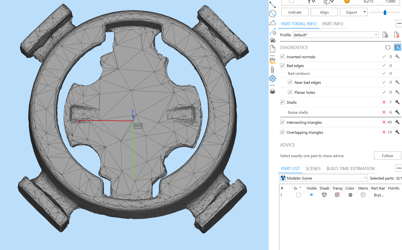

A Blender update
I was about to give up when I found out how useful the Remesh Modifier can be. lol
Basically it can reconnect the mesh if you start increasing the value of the Octree Depth (increasing the mesh density) and finding a sweet spot for the Scale.
 ![image.png](https://forum.cadmunity.com/uploads/default/original/2X/3/324040fa4b32a6b2219dcd962ee0e107a5cb95cb.jpeg)

\*Sharpness and Threshold seems to not change anything in this case.
\*don’t forget to check Remove Disconnected like I did
Part analysis in Magics. Original vs Remeshed:
Afterwards I used the Decimate Geometry with a 0.05 Ratio:
(I selected everything, but it decimates locally; meaning that you could keep the details in some desirable regions)
 ![image.png](https://forum.cadmunity.com/uploads/default/original/2X/c/cb7aae0b7f8e842f579d6db738fd9cc51d59530c.jpeg)
With two semi-auto tools it basically fixed everything. Pretty amazing :0
Original
56.0k Verts
106.8k Faces
106.8k Trits
Remeshed
146.8k Verts
146.8k Faces
293.7k Trits
Remeshed and Decimated
7.3k Verts
14.1k Faces
14.7k Trits
With Merge by Distance and Inverting selection of unconnected vertex plus delete, final clean up:
 ![image.png](https://forum.cadmunity.com/uploads/default/original/2X/4/46bddfd705cb90a980969ac7a166ec958824aafb.png)
\*I am still missing stuff, it’s being a while that I don’t use Blender… But this is good enough to import to SolidWorks or print. lol
