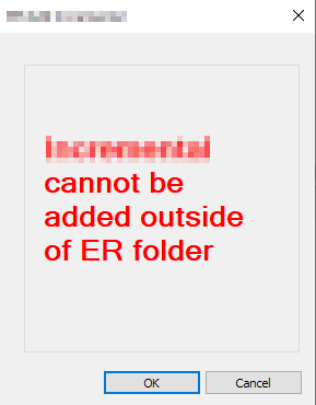

How: On my template card, I know that my ER folder will always have an ER number on it. I added control logic to all the controls to hide when the ER Number is blank (this means the user is not in the right folder when they ran the task). I also added one text block that shows when the ER number is blank “cannot be run outside the ER folder” to let the user know what to do to correctly run the template.
Now, since I can’t actually hide the template option, it’s still available through the full vault. I have the template running as a specific user that has very strict permission for file creation and no permissions for folder creation. If they try and create something outside of their permitted folder, they will get an error. So, if the user opens selects the task and selects OK, it technically submits the data card with all blank variables and they get the following error when the folder/file path doesn’t make sense.
Card shown when in wrong folder:

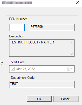

Same Card shown when in right folder:
