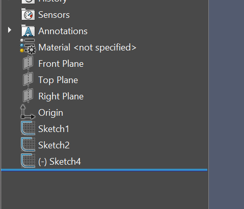

When I cancel the creation of a sketch/feature/whatever and restart it the naming system keeps increasing automatically (which makes sense), but I want it to overwrite the non-existing features.
Is it possible to do?
Manually renaming it fix the counting, but still is a boring practice.

You can tidy up your tree with this macro: https://www.codestack.net/solidworks-api/document/features-manager/rename-features-sequentially/ and after it should continue with the next available number as the index for new feature

Just rename Sketch4 to Sketch3. From then on, then next sketch will be Sketch4.
