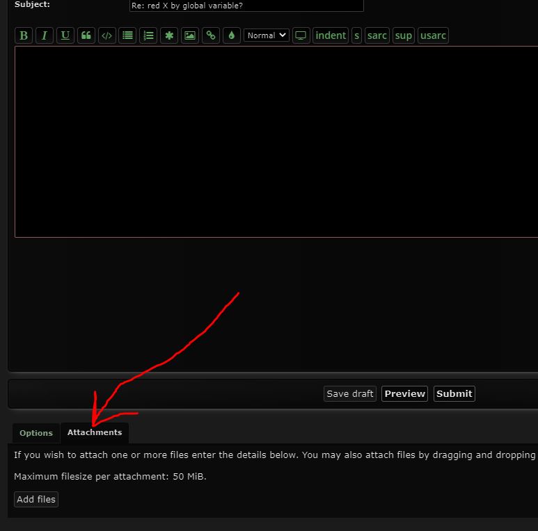

It is below the buttons, in a tab.

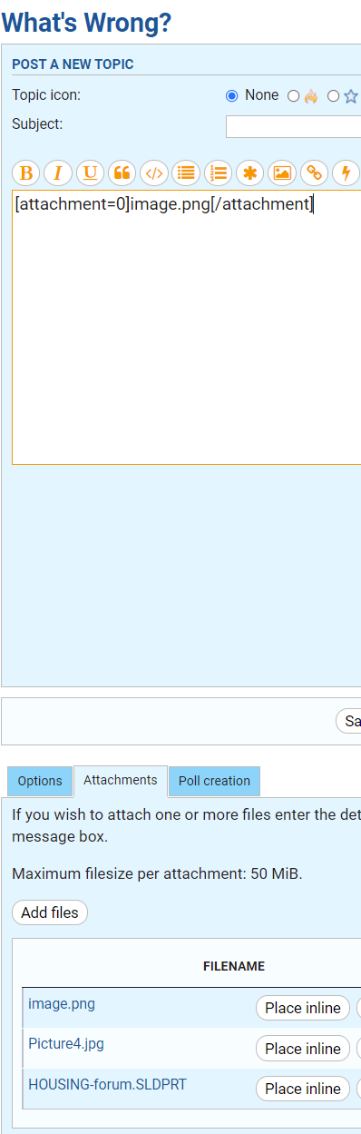

There are several ways to embed an image. If you have an image in the clipboard from a screen capture app or or something, you can just ctrl-V paste it directly in the text window (but not the quick reply, you need the full editor window). If you have an image file on your desktop, you can drag and drop it into the window. Or you can use the Attachment tab down below the text edit window to add an attachment to a post.

You should be able to attach most kinds of files. Definitely SW files should attach. If you find a type that won’t attach, you can put them in a zip and attach that. And definitely drop me a note if you think something isn’t working or you can’t figure it out. I get in here several times a day, but I’m not always here (I do have other work to do :wink: ).

I tried all those, and they all worked for me. I’m using Chrome. If you can’t upload from your work, it’s reasonable to think that you probably can’t do the other things as well. Do you see the Attachments tab under the text window?

Yes, I saw the attachments tab at the Full Editor. I’ll see if I can try it from home tomorrow.
