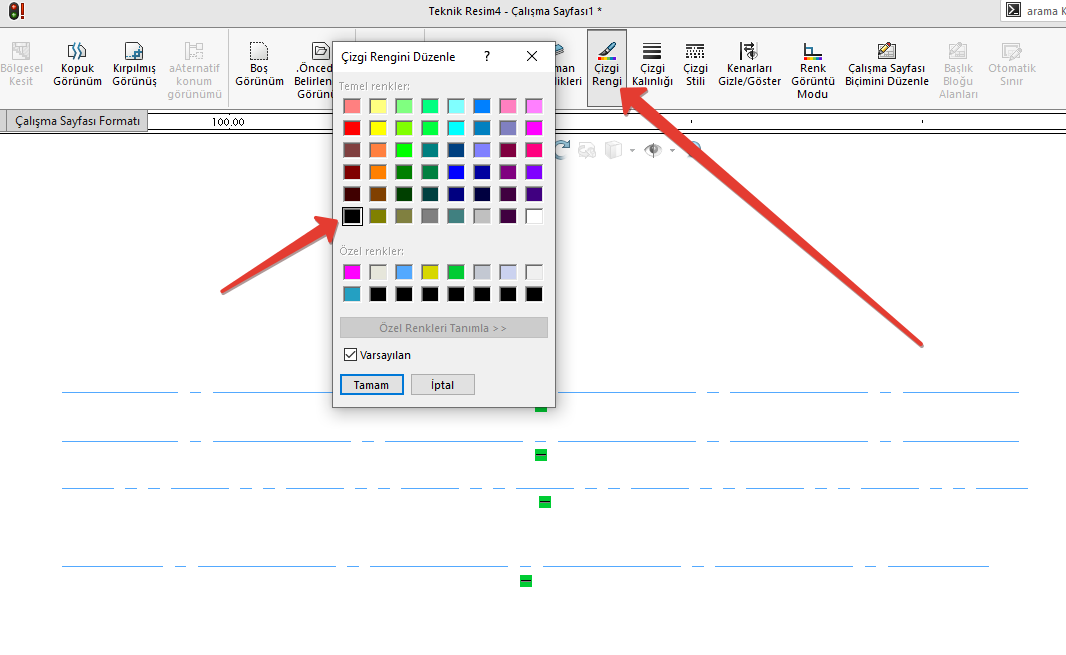

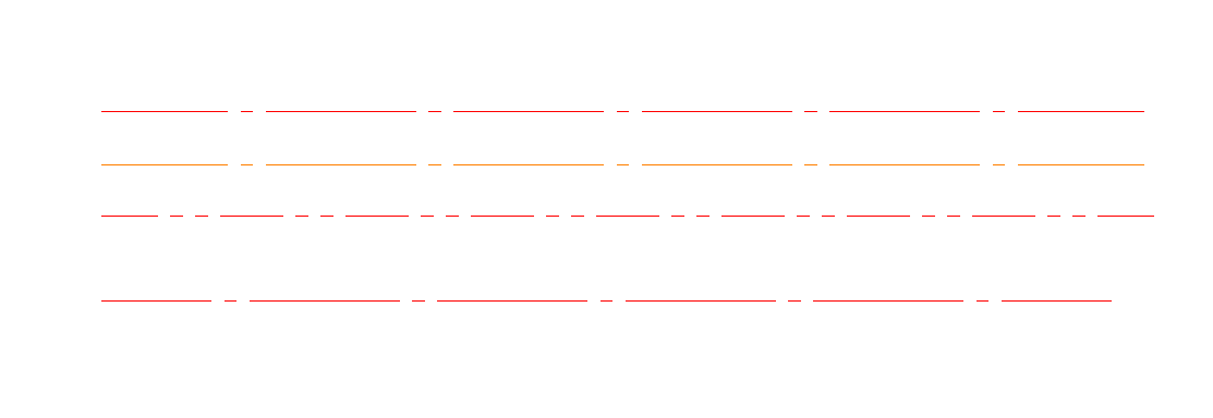

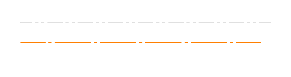

I don’t fully understand, but when I change the layer, the color changes.
or
What exactly do you mean by hidden lines?
Is this what you are searching for?
Or do you want to show hidden tangent edges in the view (which you have to do manually on each view then or with a macro on all views)?
And as far as I know (and I was just looking into this last week) JSculley is correct. Manually changing the lines would be your only option for coloring something within the view. This is, I think, because drawings are assemblies and hidden lines are edges that SolidWorks colors.
If it’s color you are wanting to change, I think you are out of luck.
I believe those are sketch lines you’re showing. He’s referring to hidden model edges in a Drawing view.
