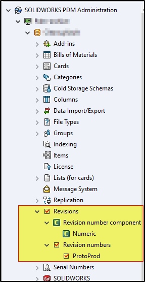

In the back of PDM there’s a revision counter, or a couple of them, for each file based on the Revision Numbers node(s) in the PDM Admin Tool. There are just a couple of things that keep the data card variable synchronized with the real rev counter for the file; or try to prevent it from being in sync with the real revision counter. I’ll probably miss a couple but try to list them;

  • Set Rev tool from right click menu, if revisions are controlled by workflow only admins have permission to this. Incidentally this is the only place I know of (outside of looking in SQL) to find out what the real revision counter is at and if it’s set to increment on the next IncRevision transition action. There’s a check box to update the data card variable. That is only allowed is the file’s current state has the “Revision Variable” set in the “Revision Numbers” tab in the state’s properties. Otherwise it doesn’t know which data card property to update. Again there’s nothing magical about a variable with “revision” in it’s name. We must tell PDM what variable to use.
  • !!! Transition action IncRevision does NOT change the data card variable. It “stamps” the version with a Revision number and will increment the actual file revision counter in the database IF (and this is where I start to loose grip)
    ++…if the file has gone through a Transition that as a revision number component selected and “Increment by” set to 1
    ++ or the source state of the transition that has the IncRevision action has Revision number component selected and increment by 1.
    The Revision Number and Revision Component both come from the nodes set in PDM Admin tool
