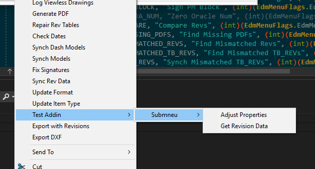

The menu structure for commands added by an add-in is controlled in the source code of the add-in itself. In the IEdmAddin5::GetAddinInfo method, commands are added via AddCmd, like this:
poCmdMgr.AddCmd(CMD_ADJUST, "Test Addin\\Submneu\\Adjust Properties", (int)(EdmMenuFlags.EdmMenu_OnlyInContextMenu | EdmMenuFlags.EdmMenu_OnlyFiles), "Adjust Custom Properties", "Adjust Custom Properties", -1, 0);
poCmdMgr.AddCmd(CMD_GET_REV_DATA, "Test Addin\\Submneu\\Get Revision Data", (int)(EdmMenuFlags.EdmMenu_OnlyInContextMenu | EdmMenuFlags.EdmMenu_OnlyFiles), "Get Revision Data", "Get Revision Data", -1, 0);
The menu structure is created by separating the menu names with a backslash character '' which in the source code has to be escaped and is written ‘\’. The above code gives a result like this:
If you have access to the add-in source code, change it there. If not, you can try disassembling the add-in(s), tweaking the strings and then re-assembling it. I just did that to add the third item shown here:

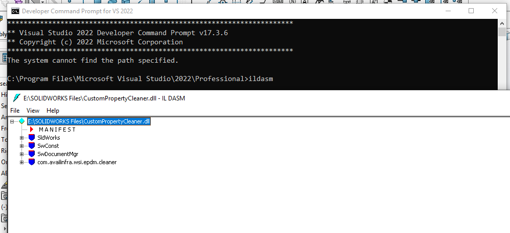

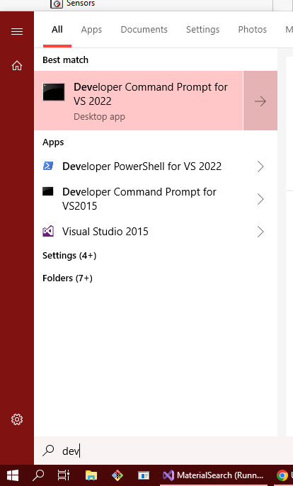

If you have Visual Studio, you can use ILDASM.EXE and ILASM.EXE to do the disassembly and reassembly. From a Visual Studio command prompt:
launch the ildasm tool and open the DLL file (make a backup copy in case you make a mistake or it doesn’t work for some reason):
From the file menu, select Dump’, use the default settings and save the file:

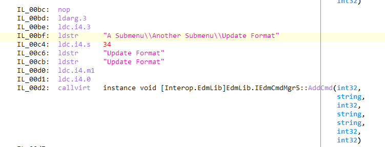

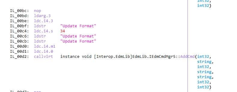

You can open the files with a text editor. You then search for the text of your menus, and you will find code like this for each menu item:
Change the first string to have the menu structure you want, using double backslashes to separate them:

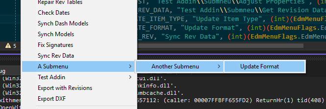

If it works, you should see your new menu structure, like this:
