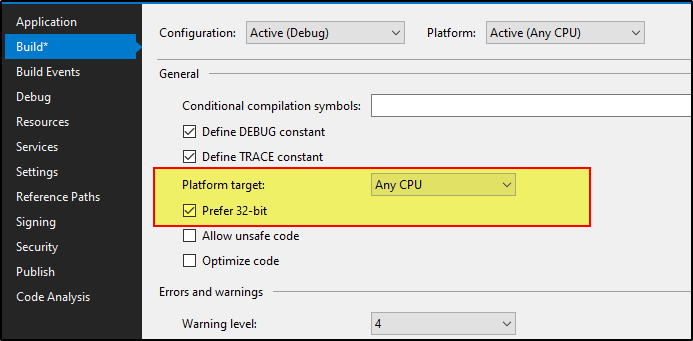

I checked the add-in project and all its dependency projects that they all have Platform Target set to x64. They did. I checked the KB for S-017655 but it’s still off line.
Continuing down the list checking things. Then it hit me, that sinking feeling I get with the dawning awareness that I’ve potentially really screwed up. I go check the Platform Target of the quick standalone console app I made to test this “problem” and it’s still set to “Any CPU” more sinking feeling. Prefer 32-bit is checked… I uncheck that one fr#$%@ng little checkbox and hit F5… Nothing, it silently flipped the state. Head to table moment. I switch the code back to our production vault and run again. Smooth sailing.
This isn’t the first time I’ve lost days of my life to compiling for the wrong platform, yet I still get nailed by this… <()> :blush:

I don’t understand all that goes on, but the 64bit dlls are registered/loaded differently than the 32bit. I don’t know if or how some add-ins register both the 32 and 64 bit. I THINK that this was a problem only for my add-in because I had a 32bit standalone trying to register a dll that was 64bit only so it was going off the rails somewhere in that process. Perhaps if my task add-in was compiled for 32bit then my 32 bit stand alone would have been fine. Maybe someone that understands the underlying mechanisms can explain it better for us.

For future ref, if you’re having dlls fail to register check this setting for your project properties. It should likely be 64bit only, or “Prefer 32-bit” NOT checked.
