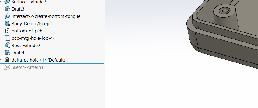

I am starting a housing model and trying to set it up for easy changes. Currently, the top and bottom housing are both in this one multi-body part.
I have a sketch that contains points that locates where my mounting bosses and holes will need to be.

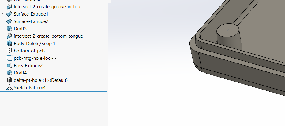

I would like to use that sketch to drive a pattern. I want to pattern the boss, draft, and library feature. My pattern didn’t want to do that so I thought I would try patterning the boss and then the hole.
When I pattern the boss, it fills in my hole.
Any ideas what I am doing wrong?

  1. remove the sketch point from the original instance. points are only for additional instances. The sketch point on the original instance is allowing the patterned post to fill in the hole.
  2. Use a real mounting boss feature. It will simplify everything
  3. make 1/4 of the entire housing, and mirror/pattern the body
There is something about how the sketch pattern is being created. It’s basically creating an additional 4 instances. “Draft-screw-hole1” is the original body. You can see how there are 4 more Sketch-pattaern6 bodies.

Just to reiterate what matt pointed out, when I patterned bodies I ended up with 5 because your sketch has 4 points. So the original instance overlaps:
This is expected behavior. If you are patterning bodies it will create a new body for each sketch point. There’s the original, and 4 more, 1 for each sketch point. So if you delete the sketch point at the original instance, you’ll have the correct number. Then you need to use a Combine or Intersect feature to knit it all back together.
