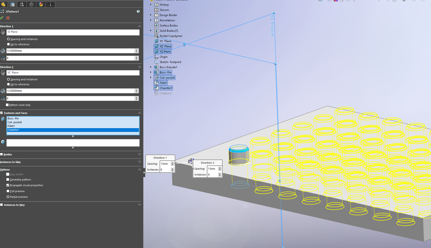

I don’t think I have seen something like this before- I want to pattern the boss and backside pocket, along with the fillet and chamfer. If I select all four, the pocket part of the pattern goes away, although it shows in the preview. If I don’t pattern the chamfer, I get it back. If I move the chamfer below the pattern, the pocket goes away again. No errors get thrown up. Verification on Rebuild is turned on. Anyone with an insight into what is going on? I am fairly sure I can work around this, but this sure seems odd.
The pattern works if you avoid the “offset from surface” and just use a blind (maybe with an equation which achieves the same thing), and it also works if you use Pattern Faces instead of Pattern Features. Geometry Pattern doesn’t seem to affect it, which seems odd.

If you create a plane coincident with the top face of the boss and use the plane as the ‘Offset from surface’ entity, everything works.

Having “Offset from Surface” bamboozle the feature, when that surface doesn’t yet exist, makes sense, and also why using a plane would work. Except the pocket gets patterned if the chamfer is in the tree but not selected.

Is this what you are looking for?
That gets the pattern to work, but loses the associativity of the end condition. I am at a loss to explain why the chamfer has to be in tree above the pattern but can’t be selected as part of the pattern. I am going to chalk this up to bug that I would guess isn’t easily understood.
