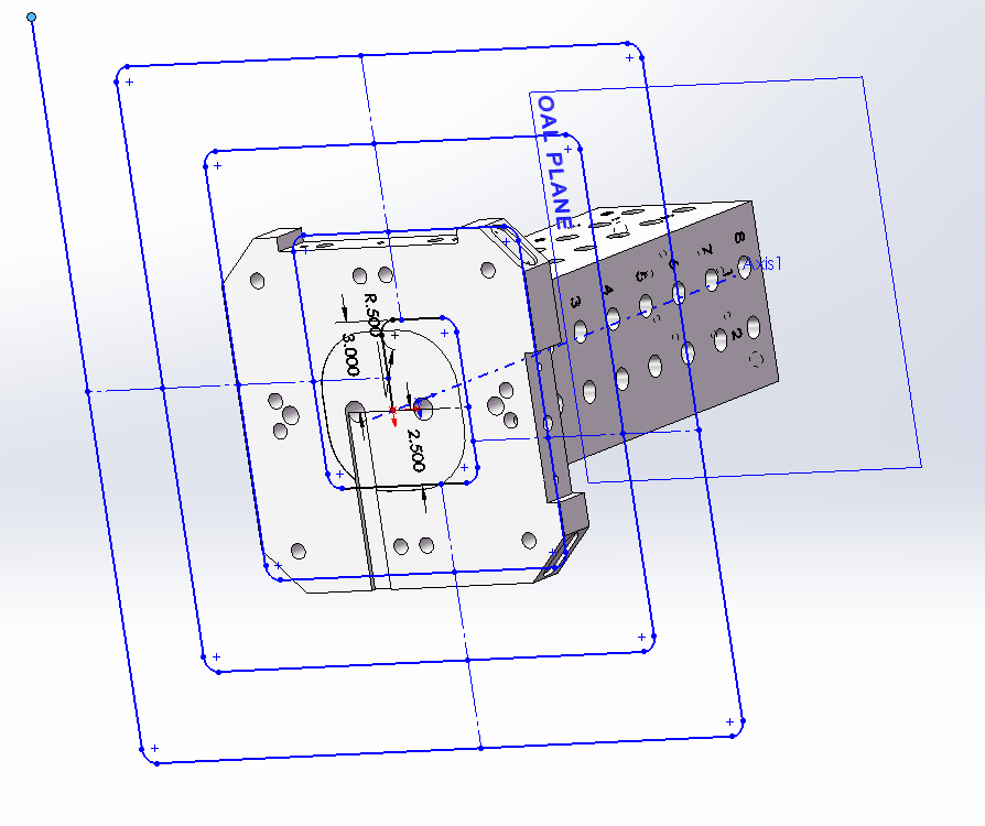

I have a situation where I have a “Square Spiral” path in a sketch. This “Path” needs to change length based on the size of part it is associated with. What I’m attempting to do is to have the start point of the path and the end point of the path remain in the same relative position to the part but have the distance between each leg of the spiral remain with in a certain range.
So on a small part you might have three “Legs of the spiral” while on a large part you might have five legs of the spiral.
Can any of you bright individuals think of a way to do this without a macro? I can’t use a macro because I’m using this in driveworks Express and it won’t run macros.
I looked at a path length dimensions but that will not go any further than the first corner as it requires the removal of an entity. I think I could do this with a spline but since this is going to be a cam path instead of a simple arc at the corners I would have 10 pages of G-Code for each corner…which I don’t want either. So what I’m looking for would be something like this.

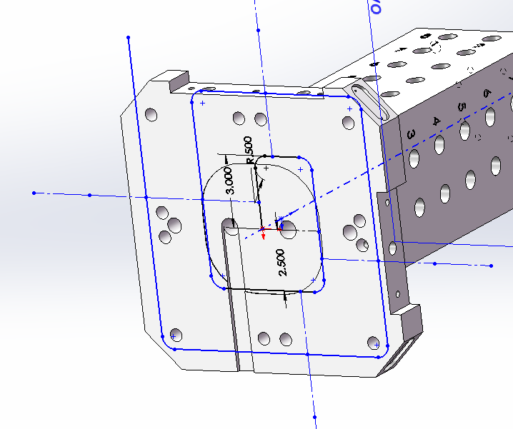

So I actually found something that works for what I’m trying to do.
In the Driveworks model I put the largest possible spiral I will ever need. I also place the CAM path on that spiral.
In the formula’s in the driveworks model I alter the spiral to match the needs of the part being generated and locate a “Trim line” in the same sketch.
When the model is generated all you need to do is to go in and trim/extend the start point of the spiral to the generated trim line, it’s in the correct position since it was put there by Driveworks, delete anything not need and regen the path in CAMWorks…done.
